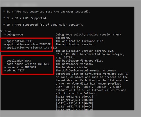

    Coming back to this topic. I found the "Bug". The generated zip package with the line:
    nrfutil pkg generate --hw-version 52 ...
    only contained the hex file from the application. If I do the same for the bootloader, I can update only the bootloader over OTA:
    nrfutil pkg generate --hw-version 52 --sd-req 0x0100 --bootloader-version 1 --bootloader boot_test.hex --key-file private.key G3_bootloader.zip
    and its working.

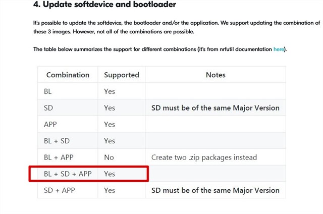

    Is there a possibility to create a zip package which includes the app and bootloader?
    Here they are discussing the same "Problem" and is the only solution 2 zip packages? is there no other solution?
    https://devzone.nordicsemi.com/f/nordic-q-a/63895/how-to-generate-a-bootloader-softdevice-application-zip-for-ota-updates-dfu/261014
    Thanks for any inputs
    You are right, an update zip consisting of application and bootloader is not supported. Generally, all combinations except for that is supported (see 4. Update softdevice and bootloader). Other than that, I do not have anything to add part from what is already in this post in the thread you mentioned.
