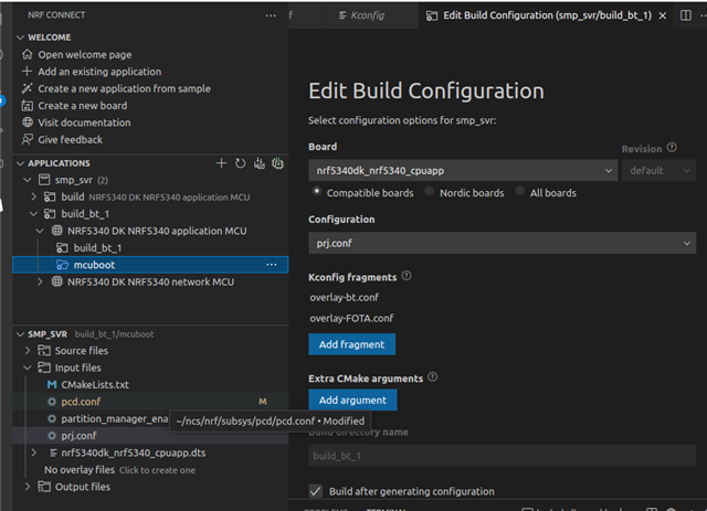

how to give child image add fragment(overlay.conf) via VScode gui?
 I  use  the  vscode to creat a smp_svr sample project  ,and how can i easily add fragment to child image(mcuboot)?
as the picture1, the files overlay-bt.conf overlay-FOTA.conf both are serve to the main image "build_bt_1"
and the picture2 ,the pcd.conf and partition_manager_enable.conf  are serve to the child image “mcuboot”
where can i add fragment to the mcuboot  like picture1(edit build configuration -> kconfig fragments -> add fragment)
Or can i use a special naming method (config macro or file name) in overlay.conf transfer it from the primary image to the sub image
My expression may be vague,i just want to transfer config macro to child image  via add fragment

    i know that can add some sentence to the <sample>\child_image\mcuboot\prj.conf , but the effect not i wonder
    i want to creat a new file  for "build configuration -> kconfig fragments -> add fragment" , which can let new colleague build a new project easily  ,the new file overlay.conf   contains the macro configuration that the parent image wants to pass to the child image
  • I think I understand what you want to achieve, however, there is no buttons in the VS code. You will need to follow the steps provided in the link I provided.

  • If you have "Created a new application from sample" and chose smp_svr. You should only need to add a folder named child_image and then a file e.g. mcuboot.conf. This file will act as fragment for the child image
    In this .conf file can add the needed KConfig configurations e.g. CONFIG_BOOT_UPGRADE_ONLY=y
    There is no need for the second folder in child_image, e.g. <sample>\child_image\mcuboot\prj.conf as described in the link in my previous comment:
        # Note: The folder `child_image/<ACI_NAME>` is only need when configurations
        #       files must be used instead of the child image default configs.
        #       The append a child image default config, place the addetional settings
        #       in `child_image/<ACI_NAME>.conf`.
    Where ACI_NAME is mcuboot in your case.
    Hopes this helps.
