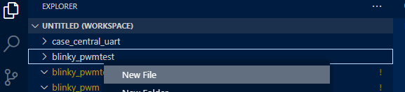

    Sorry for the long response time. As per the error, the Application is not able to read the MYFUNCTION. I think it's the problem with the Kconfig file you have created as stated here. Can you try creating a Kconfig file through VScode? For that, use the explorer, go to your project and right click on new file. Explorer-->your_project_Name(right click)-->New file. Please see the attached screenshot for your reference.

    I followed your advice and I created a Kconfig  file using VS code and this resolved the problem. Thanks for your advice.
