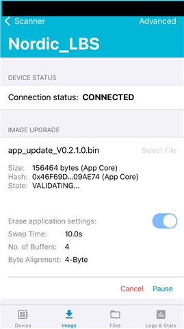

1)What modifications are required for the nRF5340 with an app core and net core?  This example shows using Device Manager to upload a .bin file but that is only one of the app core or net core, not both.  Can Device Manager accept a the generated .zip with the manifest to update both at once?  Could a similar guide be generated for updating both the app and net cores at the same time?  When trying to upload the zip of both, Device Manager shows the hash of both bin files, but when started with confirm only, the state shows VALIDATING… for a while then “Sending the request timed out.”  When using the advanced page, I can manually select the app core and download the bin for it – not the zip.

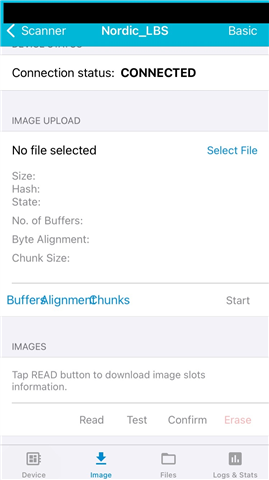

2)In Device Manger, the read, test, confirm, and erase options do not work.  How can they be activated?
    What do you mean by this?
    Does this window not show up when clicking on "Start"?
    Do you mean that these are greyed out (you can see this view by clicking on "ADVANCED" in the top right corner)?
    You need to click on "READ" for "TEST", "CONFIRM" and "ERASE" to be clickable.
    Or do you mean that these options are visible, but it fails/nothing happens when you click on them?

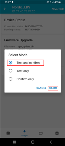

    3)The guide said that Device Manager will reset the device after the transfer but watching the debug output on the device, this is not the case.  I need to manually press the advanced button to get the reset command to show then issue it.  Is this correct?
    I was not able to reproduce this. I modified the peripheral_lbs sample and followed the steps in the guide using NCS v2.0.0 and the nrf5340dk_nrf5340_cpuapp, and the device reset after the transfer completed:
    I noticed that I had to do a pristine build, in order for the build time print to be different. If this printk is the same, the image will be the same and the hash will be the same, and the update won't even start.
    Here is the sample I used

  • Thank you for your answers.  I think a large problem is that the nRF Connect Device Manager is not working correctly.  Using the Nordic_LBS example and modifying for the DFU similar to the guide, the iOS version of the Device Manger struggles.  First it validates for a while
    Then it times out
    and the commands to test or confirm do not work after the read is issued:

  • So there are currently two issues:
    1. Performing DFU using your firmware and the Android Device Manager 1.4.0 fails
    2. Performing DFU using the peripheral_lbs from the DFU guide and the iOS Device Manager v1.2.5 fails
    Regarding 1, would you be able to upload your firmware (or a minimal reproducible sample), so I can reproduce it on my side and investigate it
    Regarding 2, I don't have an iOS device at my home office, but I will ask some colleagues to reproduce this on Monday
    Simon
    I got a colleague to test this with an iPhone, and he got the same error as you: "Sending the request timed out."
    I have reported this internally. I will keep you updated.
