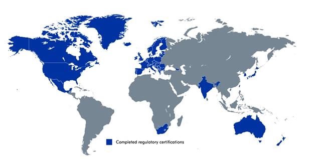

  • In my region - Vietnam, it doesn't have regulatory certification for nRF9160. So in my country can I use this DK ?
  • Yes, the Thingy:91 is designed to work in all countries given that LTE-M and NB-IoT is enabled and the SIM is supports these.
