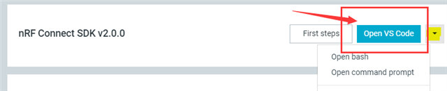

  • Hi  Maria,

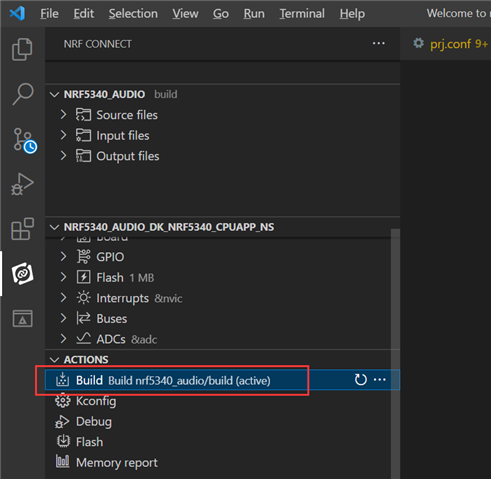

    I  used nRF Connect for Desktop as described Installing automatically, I encounter a another question when I build using VS Code, the error log as belowed.
    e:\admin\homework\nrf5340_audio\nrf5340_audio\src\bluetooth\ble_core.c:49:7: note: each undeclared identifier is reported only once for each function it appears in
    [73/279] Building C object CMakeFiles/app.dir/src/modules/audio_i2s.c.obj
    [74/279] Building C object CMakeFiles/app.dir/src/audio/audio_datapath.c.obj
    ../src/audio/audio_datapath.c: In function 'cmd_i2s_tone_play':
    e:\admin\homework\nrf5340_audio\nrf5340_audio\src\audio\audio_datapath.c:920:14: warning: implicit declaration of function 'strtof'; did you mean 'strtol'? [-Wimplicit-function-declaration]
    920 | amplitude = strtof(argv[3], NULL);
    | strtol
    [75/279] Building C object CMakeFiles/app.dir/src/drivers/ina231.c.obj
    [76/279] Building C object CMakeFiles/app.dir/src/drivers/max14690.c.obj
    FATAL ERROR: command exited with status 1: 'e:\admin\Nordic\SDK\toolchains\v2.0.0\opt\bin\cmake.EXE' --build 'e:\admin\homework\nrf5340_audio\nrf5340_audio\build'
    * The terminal process terminated with exit code: 1.
    * Terminal will be reused by tasks, press any key to close it.

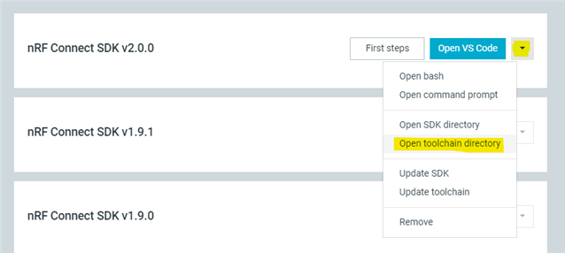

    The definition of strtof is a part of the Zephyr SDK. Can you please check if you have a folder named zephyr-sdk within "opt" in your toolchain directory?
    You can open your toolchain directory from Toolchain Manager.

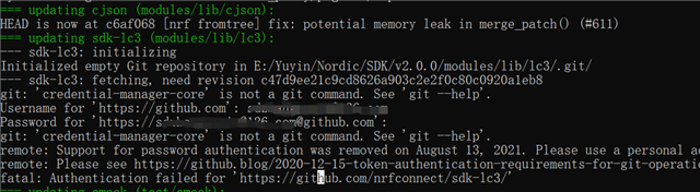

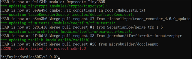

  • Hi Maria,
    thanks for your reply timely,
    The flow I operated as belowed, can you help me to check it:
    step1 :  download nrf connect desktop and command line tools, and install success;
    step2:  download sdk 2.0.0 from nrf connect desktop;
    step3:  Open Command prompt
    then input  command
    > west config manifest.group-filter +nrf5340_audio
    > west update
    but this step update lc3 failed, I use SBC instead

  • Hello Yuyin,
    The only step missing is the change of configuration from LC3 to SBC. You need to add CONFIG_SW_CODEC_SBC=y to the prj.conf in the nrf5340_audio folder.
