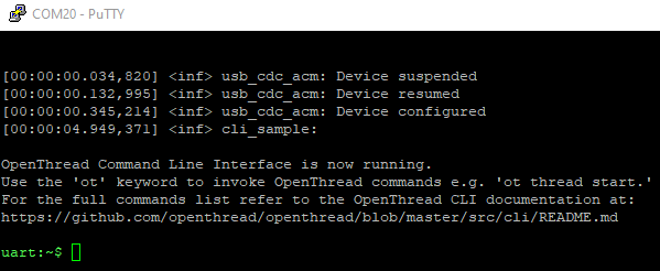

I am using the Connect SDK v2.0.0 and attempting to use TCP in the stock CLI example to mimic the demo shown here. When I flash the v2.0.0 CLI sample on my nRF52840dk, "$ ot tcp init" is not a valid command. In fact, when I run "$ ot help" I do not see "tcp" as one of the available subcommands.
I see "nrfxlib/openthread/include/openthread/tcp.h" and "nrfxlib/openthread/include/openthread/tcp_ext.h" in the v2.0.0 SDK, so I assume that this release includes the TCP-enabling commits to the main Openthread project in late 2021/early 2022. If this is true, then I assume that I must specifically enable Openthread's TCP submodule via the CLI project's "prj.conf" file. I have tried adding the last three lines in the CLI project's "prj.conf" (and other configurations based on the tickets here and here) but receive the error further below.

I can't seem to find documentation on the configuration I need to get Openthread's TCP submodule working, but I might just be looking in the wrong places. Could you please point me in the right direction to get TCP working in the CLI example? Am I not adding the right lines to the CLI sample's "prj.conf" or is more work required?
  • If I add CONFIG_OPENTHREAD_MBEDTLS_CHOICE=y to the prj.conf, I no longer get the MBEDTLS_MAC_MD5_ENABLED warning/error and it compiles. However, I still cannot use the "tcp" subcommand. Here is my new prj.conf, although I should go back and comment out the irrelevant lines that I added from other DevZone tickets related to Openthread and TCP.

    I also notice that "tcp" is included in the OpenThread CLI full commands list at the link below. There must be a reason that it didn't get carried over into this commands list in the Connect SDK? Maybe I would have luck after recompiling the OpenThread library?
    EDIT: I think it has something to do with the fact that OPENTHREAD_CONFIG_TCP_ENABLE and OPENTHREAD_CONFIG_CLI_TCP_ENABLE are not defined. If you look at cli.cpp, cli.hpp, and cli_tcp.cpp in the OpenThread CLI repository (linked further up in this reply), they all have the same IF statement containing some TCP-enabling code (two examples from cli.cpp shown below).
    However, I still do not see "tcp" as a subcommand if I create these two variables in a Kconfig file and set them =y in the prj.conf.

  • Found the issue - I needed to set
    CONFIG_OPENTHREAD_TCP_ENABLE=y
    CONFIG_OPENTHREAD_CLI_TCP_ENABLE=y
    in my prj.conf instead of CONFIG_OPENTHREAD_CONFIG_TCP_ENABLE and CONFIG_OPENTHREAD_CONFIG_CLI_TCP_ENABLE.
