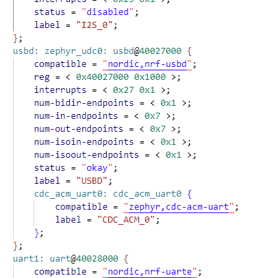

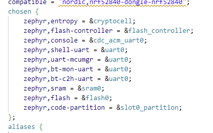

    The cdc_acm_udc0 stuff is most likely needed (it was for me). Check build/zephyr/zephyr.dts to make sure it's showing up in the final DTS.
    I think its being added to the device tree, but I'm not sure if this looks correct or not. The "build/zephyr/zephyr.dts" file has the following entries:
    And:
    And:
