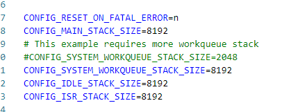

I am working on a custom board. I have included the following in the prj.conf file
CONFIG_COUNTER=y
CONFIG_COUNTER_RTC0=y
Question Two
I tried putting  "CONFIG_COUNTER_NRF_TIMER=y" in prj.conf file but getting the following error so I removed it. I guess it is related to my custom board dts file but I am not sure how to resolve it. custom board dts file is just the copy of nrf52832DK dts file.
