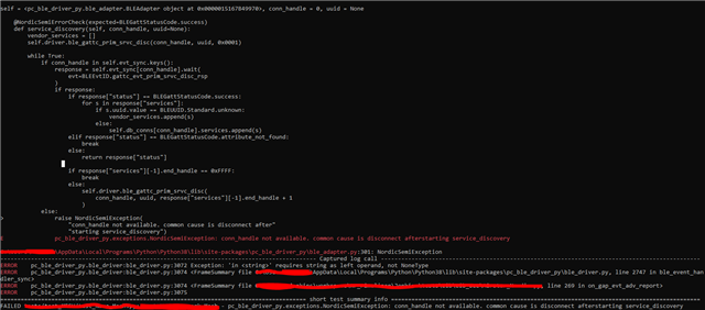

Hello, I am using the nordic nRF52840-DK with the package pc-ble-driver-py and the example heart_rate_collector.py.
My problem is that sometimes the Bluetooth connection can't connect to the device with this error :
New connection, conn_handle: 0
Disconnected, conn_handle: 0, reason: BLEHci.conn_failed_to_be_established
I know that this error can sometimes occurred. But I would like to know how can I reconnect automatically just after this error ?
Knowing that this error is problematic because it stop my python script lunched from a batch file.
Thanks in advance.
Gaetan
    I have check but the disconnection is not because of the range. Indeed, the driver works most of the time.
    Also I already check if the peripherals keep advertising and it doesn't seem to be related because they keep advertising.
    Concerning the python script, it doesn't crash when I disconnect, It crash when a random disconnect appear.
    My question is this one, how to reconnect to the device after a random disconnection in my script.
    Gaetan
    How do you connect in the first place? I assume that it is some API that you have already used to connect to your device? Perhaps you can share with me what your current script looks like?

    Either way, if you want to continue after the disconnection, you should remove the exception that is raised. There is no need to continue the service discovery if they are not connected. Instead, you should start scanning again after the disconnect.

  • Yes it is exactly what i want to do ! I want to stop the service discovery after a disconnection and start scanning again after the disconnect.
    But how can I do this because my code will continue to be execute ?
    Gaetan
  • Did you try to remove the line that raises the exception?
    If not, please try this.
  • Yes I already try it but when I have the connection pb the program remains in the while true and cannot get out of it
  • Try replacing the
                    raise NordicSemiException(
                        "conn_handle not available. common cause is disconnect after"
                        "starting service_discovery")
    with
    break
    Or even better, with something that starts scanning again.
    I am not familiar enough with pc-ble-driver-py to tell you exactly what that needs to be.
    Try to read from the logs when you start the application if you can deduct what functions that are called to start the scanning.
