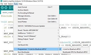

    I found that when I burnt a bootloader using this setup in Arduino IDE, the bootloader is burnt on the SoC on the DK board instead of the dongle. So I think the DK board is not detecting the dongle. Is there any other ways to check this?
    I also found this statement in the manual.
    "If it is inconvenient to have a separate power supply on the external board, the nRF52840 DK can supply power through the Debug out connector (P19). To enable this, short solder bridge SB47. While SB47 is shorted, it is not possible to program the onboard nRF52840 SoC even if the external board is unplugged." -link
    Would you recommend shorting SB47 and don't plug in the dongle USB anymore but instead supply power from DEBUG OUT SWD interface?
