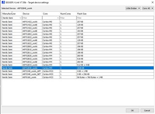

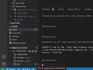

The dongle is still flashing the green LED but I cannot detect a serial port anymore. Instead, I can only see the two j-link virtual ports. None of them is printing any debug logs. There's also RTT logging feature on the VS code and when it's selected I get this pop up and choose the right board as shown. I can see the green LED on DK board flashing very fast although I have no idea why is that.
However, nothing is still printed.

    First off, it might be that the RTT viewer in the nRF Terminal is not working as expected for some reason, but you could try out the J-Link RTT viewer instead, as that is a bit more stable. Also, can you show me how you've enabled the RTT logging in your application, and let me know what SDK and SDK version you're using for development?
    As for the green LED flashing "very fast", I assume you mean faster than expected when it runs the normal Blinky application, but can you still see it physically blinking or does it appear to just be on?

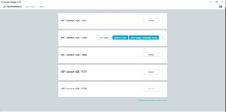

  • Hi, I'm using the nRF connect SDK v1.9.0 which is installed using the nRF Connect for Desktop toolchain manager app.

    I see you're using nRF Connect SDK v1.9.0. Is there a reason you're not using the latest version (v1.9.1) which has both features added and bugs/issues fixed?

    4. I will update to v1.9.1, no problem.
