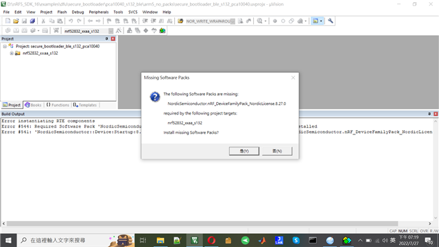

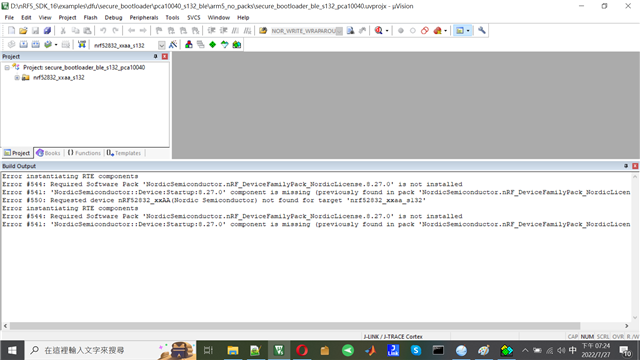

Keil can't build secure_bootloader project
I would like to using Keil to build secure_bootloader project for changing NRF_DFU_BLE_REQUIRES_BONDS from 0 to 1. But Keil failed to build. Please refer to snapshot of Keil.

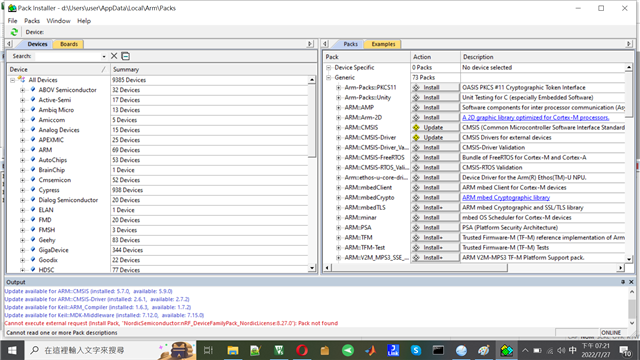

  • A description on how to update to new MDK (device family pack) in Keil for older nRF5 SDK is described here:
     RE: MDK uVision SDK 16.0 keil Family Pack Installation
    Kenneth
  • Thanks for your support! I have solved Keil Family Pack installation issue. Now Keil complains can't find nrf52_erratas.h and uECC.h. Do I miss something?
