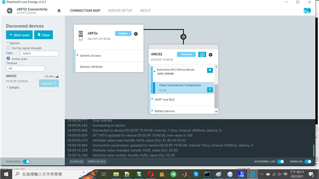

nRF52832 buttonless DFU without bonds failed
I use nRF Connect to test  buttonless DFU without bonds failed. But nRF52832 receives BLE_GATTS_EVT_SYS_ATTR_MISSING event.

-> Code0> <debug> nrf_ble_gatt: Requesting to update ATT MTU to 185 bytes on connection 0x0.
 0> <info> app: BLE_GAP_EVT_CONNECTED
 0>
 0> <debug> app: state=1
 0>
 0> <debug> nrf_ble_gatt: ATT MTU updated to 185 bytes on connection 0x0 (response).
 0> <info> app: BLE_GATTS_EVT_SYS_ATTR_MISSING
    What SDK version are you using?
    Can you provide the log from the nRF Connect?
    Please try to erase the kit before programming.
    Amanda

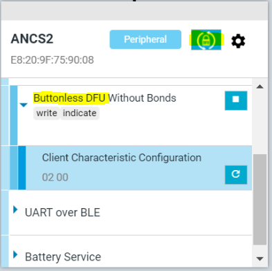

  • After I restart nRF Connect, it can connect to nRF52832 device. How can I trigger nRF52832 device to enter DFU mode from nRF Connect?

    It has the buttonless DFU service, so it doesn't need to trigger to get into DFU again.
    -Amanda
  • Which event will be received in nRF52832 device when I press "Button DFU without bonds" soft key? I can't see any BLE_DFU_EVT_BOOTLOADER_xxx events in log messages. But ble_dfu_buttonless_init() return 0.:

    Do you write opcode 0x01 to get into DFU mode?
    Have a look at this Buttonless Secure DFU Service without bonds doc.
    -Amanda

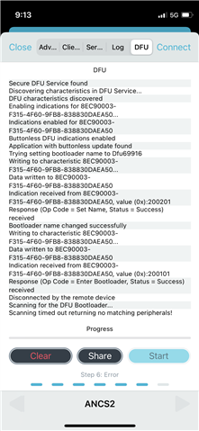

  • I try to use iOS nRF Connect APP to perform DFU. But it failed with "scanning timeout returning no matching peripheral". Why no bootloader log messages after BLE_DFU_EVT_BOOTLOADER_ENTER_PREPARE event?
    The following is log messages of nRF52832 device.

    00> <info> app: BLE_GAP_EVT_AUTH_STATUS
    00>
    00>
    00> <info> app: BLE_DFU_EVT_BOOTLOADER_ENTER_PREPARE
