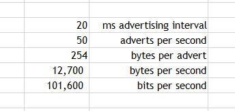

    I wonder if periodic advertising could work with 4khz 12bit uncompressed audio. It works out at 6144 bytes per second.I believe the maximum data length for periodic advertising is 254 bytes, and the minimum interval is 20ms. I think it works out at 101,600 bits per second.
