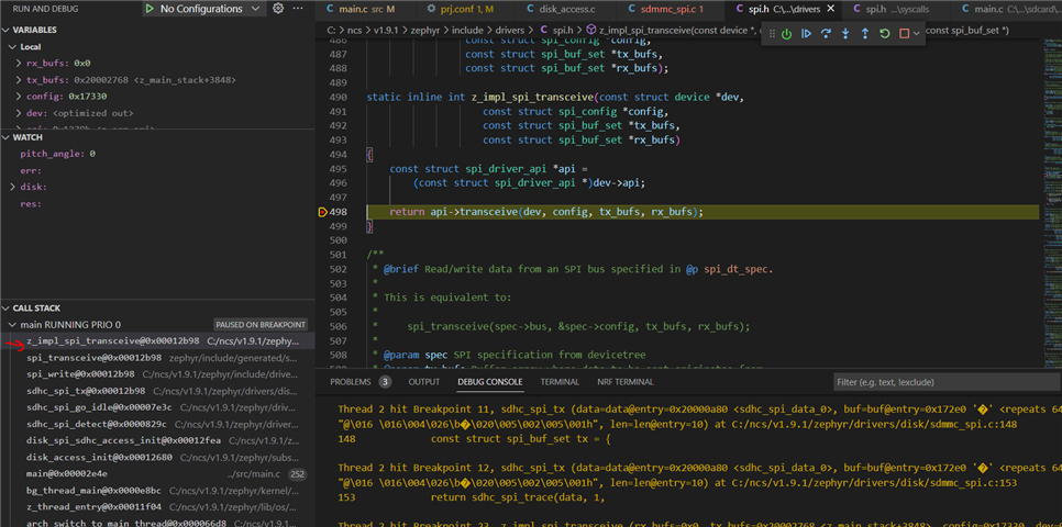

EDIT1:
I have traced the stacks just before the systes reboots back to the main function, its  'z_impl_spi_transceive()' function. Here is the stack call-list,
