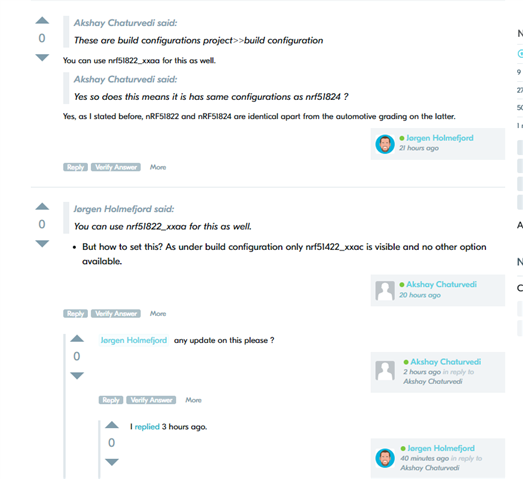

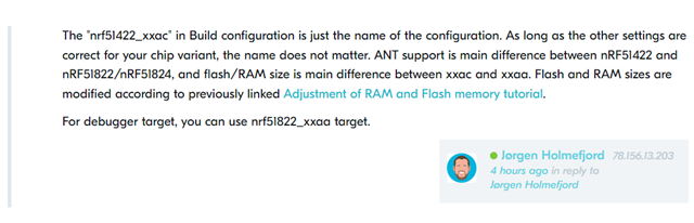

Hi all,
I am about to purchase NRF51-DK Nordic Semiconductor ASA | Development Boards, Kits, Programmers | DigiKey but this says for nRF51422, nRF51822 series Transceiver;
I am not sure if nrf51824 works on this?

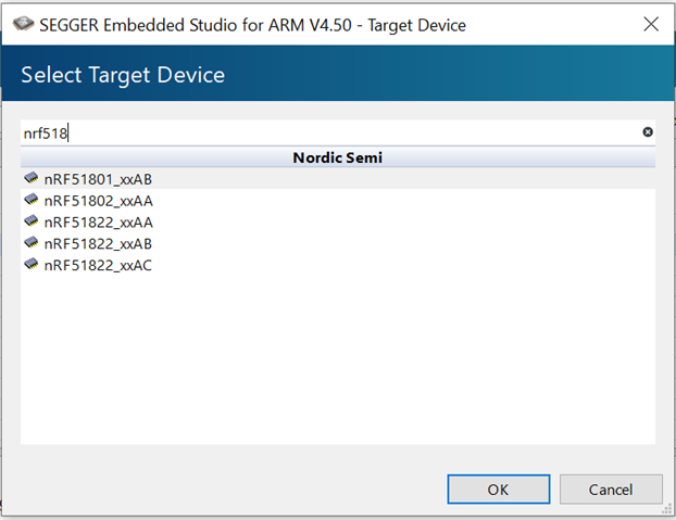

If yes then where in project settings we need to specify this change (I know segger doesnt directly support nrf51 series so I am following the guide from here Segger Embedded Studio support for NRF5_SDK_12_3_0_d7732ad (This is not a question.) - Nordic Q&A - Nordic DevZone - Nordic DevZone (nordicsemi.com))
Please help me out with this
