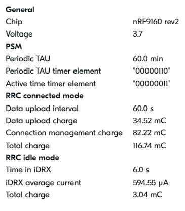

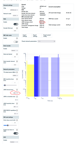

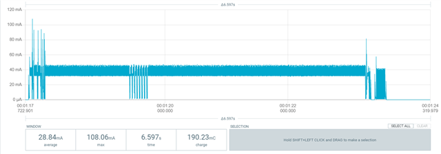

  • Hi, many thanks for your responses, and they are extremely helpful. I've been following the article you referenced (here) and have managed to get close to the given value of ~3.3uA when the nRF9160 is in PSM mode. However I was wondering how I might get an estimate for the charge supplied when the nRF9160 is making its data transmission to the UDP server?
    For example, using the Online Power Profiler, the value given was approximately 116 mC but the actual value measured is closer to 190 mC.
    Online PPK result:
    Result from PPK2:
    I was just wondering if it's possible to get a sanity check as to whether or not the values I've obtained are in the ballpark or is something off about my measurements. Thanks.
    It looks correct. Looking at your plot, it does not seem to enter connected DRX, but keeps RX on the entire time. You can simulate this by setting cDRX interval to 10ms, like this:
    You will then see that cDRX(RRC connected) average current is around 35mA, which is about what you have in your PPK plot.
