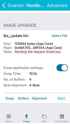

NCS1.9.99, VSCode, peripheral_lbs_DFU
nRF5340-DK DFU got error:
IOS sending time out, android apk i have not fond.

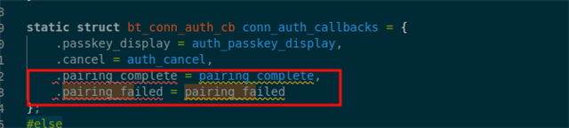

I built your project against SDK v2.0.0, but was not able to replicate the error. Could you try the same?
Note: I had to remove these struct elements to build your project:

thank you very much,
i remove tow line,the same "sending time out".
and as follow is a Simpler example, it work well in NCS1.9.1,
but in NCS1.9.99 the same error "sending time out".
i don't know why!

thanks for reply,
i've update to NCS2.0.99,
but the two project got the same error, "sending time out "

android DeviceManage app DFU got ok,
ios phone sending time out.
even ios app i've remove and reinstll it.
