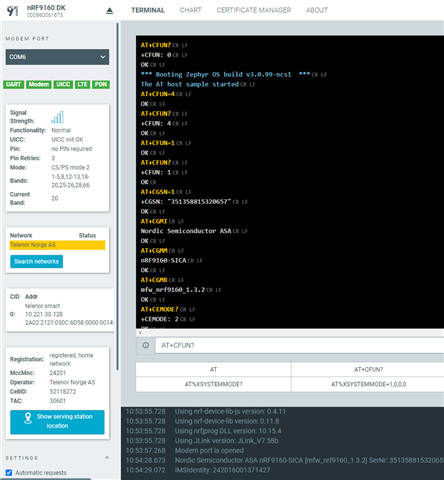

LTE Link Monitor Issue with 9160
I was starting to develop for our own board based on the nRF9160 where we will just be using the LTE-M and while doing so, ran into issues with enabling the LTE. To do a sanity check, I went back to the 'at_client' example in the nRF Connect SDK 2.0.2 and programmed it on. I opened up the LTE Link Monitor v2.0.1 and this is what I'm seeing -- all the status indicators are red or gray:
I was able to get the Modem and UICC to turn green *once* by pulling out the SIM card and putting it back in, but then restarted the board and everything is red again. Here is my log file contents:

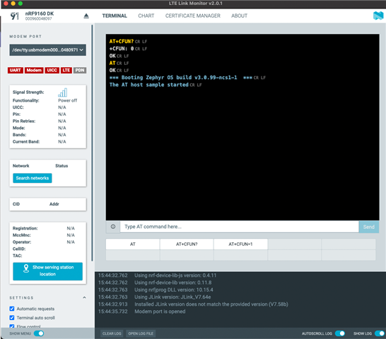

2022-08-01T21:44:31.667Z DEBUG Application data folder: /Users/user/Library/Application Support/nrfconnect/pc-nrfconnect-linkmonitor
2022-08-01T21:44:32.762Z INFO Using nrf-device-lib-js version: 0.4.11
2022-08-01T21:44:32.762Z INFO Using nrf-device-lib version: 0.11.8
2022-08-01T21:44:32.763Z INFO Using nrfjprog DLL version: 10.15.4
2022-08-01T21:44:32.763Z INFO Using JLink version: JLink_V7.64e
2022-08-01T21:44:32.895Z DEBUG App pc-nrfconnect-linkmonitor v2.0.1 official
2022-08-01T21:44:32.895Z DEBUG App path: /Users/user/.nrfconnect-apps/node_modules/pc-nrfconnect-linkmonitor
2022-08-01T21:44:32.895Z DEBUG nRFConnect 3.11.1, required by the app is (^3.8.0)
2022-08-01T21:44:32.895Z DEBUG nRFConnect path: /Applications/nRF Connect for Desktop.app/Contents/Resources/app.asar
2022-08-01T21:44:32.895Z DEBUG HomeDir: /Users/user
2022-08-01T21:44:32.895Z DEBUG TmpDir: /var/folders/0l/h7c0fmrn2s99zfj4sb1qlk_r0000gn/T/
2022-08-01T21:44:32.913Z INFO Installed JLink version does not match the provided version (V7.58b)
2022-08-01T21:44:35.732Z INFO Modem port is opened
2022-08-01T21:44:35.759Z DEBUG modem >> AT+CFUN?
2022-08-01T21:44:35.801Z DEBUG modem << +CFUN: 0
2022-08-01T21:44:35.804Z DEBUG modem << OK
2022-08-01T21:44:40.573Z DEBUG modem >> AT
2022-08-01T21:44:40.585Z DEBUG modem << OK
2022-08-01T21:44:51.655Z DEBUG modem << *** Booting Zephyr OS build v3.0.99-ncs1-1  ***
2022-08-01T21:44:51.676Z DEBUG modem << The AT host sample started
2022-08-01T21:45:13.078Z DEBUG modem >> AT+CFUN?
2022-08-01T21:45:13.088Z DEBUG modem << +CFUN: 0
2022-08-01T21:45:13.125Z DEBUG modem << OK
2022-08-01T21:45:14.661Z DEBUG modem >> AT+CFUN=1
2022-08-01T21:45:14.705Z DEBUG modem << OK
2022-08-01T21:45:48.294Z DEBUG modem >> AT+COPS=?
2022-08-01T21:48:48.295Z ERROR Network search failed: Error: 'AT+COPS=?
' timed out
What could possibly be going wrong here? I thought I was just configuring our new project incorrectly, but now using the 'at_client' example I get the same behavior.

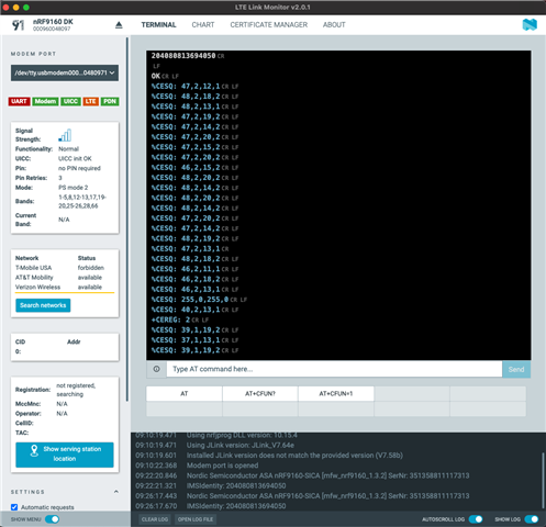

  • Benjamin,
    It appears that you are having issues with your SIM connecting to the tower. The CEREG:2 indicates that the UE is still searching for a network to attach to. The RSRP levels show good signal. In your screen shot it looks like you are averaging -94 dBm. Then you see the -255 where the board lost the connection and then the signal level is then -100 dBm. At this point you get the CEREG:2 indicating the UE is searching for the network still.
    Can you add these AT commands to help provide more information?
    AT+CEREG=5
    AT+CNEC=24
    AT%CESQ=1
    AT+CSCON=3
    AT+CMEE=1
    AT%XMODEMTRACE=1,2
    AT+CEINFO=1
    AT%MDMEV=1
    AT%XMONITOR
    The LTE Link Monitor application only polls during the Automatic update when you send AT+CFUN?. If any of the display buttons change after the initial script the condition won't be updated until the next auto script.
    Are you using Linux or Apple ? The screen shows the board as a logical device. The Windows version is not similar.
    The screen shots limit what we can see compared to posting the Log File. The log file is much more helpful. The binary trace file is even better to help troubleshoot the issue you may be having.
    Don
  • I'm running on an M1 Mac.
    I ran those commands after the device had been on for over 10min I believe, here is the resulting log file. Thank you for your help!

    2022-08-02T20:18:46.318Z DEBUG modem << %CESQ: 34,1,19,2
    2022-08-02T20:18:46.352Z DEBUG modem << +CEREG: 2,"F1D4","016186CB",9
    2022-08-02T20:18:46.389Z DEBUG modem << %CESQ: 36,1,25,3
    2022-08-02T20:18:46.605Z DEBUG modem << +CNEC_EMM: 11
    2022-08-02T20:18:46.614Z DEBUG modem << +CEREG: 2,"F1D4","016186CB",9,0,11
    2022-08-02T20:18:46.939Z DEBUG modem << %CESQ: 36,1,20,2
    2022-08-02T20:18:46.981Z DEBUG modem << %CESQ: 255,0,255,0
    2022-08-02T20:18:48.959Z DEBUG modem << %CESQ: 47,2,11,1
    2022-08-02T20:18:48.968Z DEBUG modem << +CEREG: 2,"9C14","06E9E03B",9
    2022-08-02T20:18:50.106Z DEBUG modem << +CNEC_EMM: 15
    2022-08-02T20:18:50.156Z DEBUG modem << +CEREG: 2,"9C14","06E9E03B",9,0,15
    2022-08-02T20:18:51.246Z DEBUG modem << %CESQ: 255,0,255,0
    2022-08-02T20:18:51.260Z DEBUG modem << +CEREG: 2
    2022-08-02T20:19:00.527Z DEBUG modem << %CESQ: 49,2,16,2
    2022-08-02T20:19:27.295Z DEBUG modem << %CESQ: 48,2,9,1
    2022-08-02T20:19:30.419Z DEBUG modem << %CESQ: 48,2,15,2
    2022-08-02T20:19:32.462Z DEBUG modem << %CESQ: 255,0,255,0
    2022-08-02T20:19:37.557Z DEBUG modem << %CESQ: 44,2,13,1
    2022-08-02T20:19:37.572Z DEBUG modem << +CEREG: 2,"0D92","0034571E",9
    2022-08-02T20:19:37.896Z DEBUG modem << +CNEC_ESM: 32,0
    2022-08-02T20:19:37.906Z DEBUG modem << +CNEC_EMM: 19
    2022-08-02T20:19:37.912Z DEBUG modem << +CEREG: 2,"0D92","0034571E",9,0,19
    2022-08-02T20:19:38.327Z DEBUG modem << %CESQ: 255,0,255,0
    2022-08-02T20:19:38.608Z DEBUG modem << %CESQ: 48,2,15,2
    2022-08-02T20:19:38.617Z DEBUG modem << +CEREG: 2
    2022-08-02T20:20:14.293Z DEBUG modem << %CESQ: 255,0,255,0
    2022-08-02T20:20:14.766Z DEBUG modem << %CESQ: 44,2,14,2
    2022-08-02T20:20:16.250Z DEBUG modem << %CESQ: 44,2,21,3
    2022-08-02T20:20:34.171Z DEBUG modem << %CESQ: 42,2,15,2
    2022-08-02T20:20:59.771Z DEBUG modem << %CESQ: 44,2,20,2
    2022-08-02T20:21:30.490Z DEBUG modem << %CESQ: 41,2,14,2
    2022-08-02T20:21:38.171Z DEBUG modem << %CESQ: 43,2,20,2
    2022-08-02T20:27:28.891Z DEBUG modem << %CESQ: 42,2,15,2
    2022-08-02T20:27:46.810Z DEBUG modem << %CESQ: 45,2,23,3
    2022-08-02T20:27:51.932Z DEBUG modem << %CESQ: 45,2,18,2

    2022-08-02T20:31:38.071Z DEBUG modem << +CEINFO: 1,1,R,8,1,-98,0
    2022-08-02T20:31:38.270Z DEBUG modem << +CSCON: 1,7,4
    2022-08-02T20:31:38.329Z DEBUG modem << +CEINFO: 1,1,C,2,1,-98,0
    2022-08-02T20:31:38.403Z DEBUG modem << +CNEC_ESM: 32,0
    2022-08-02T20:31:38.430Z DEBUG modem << +CNEC_EMM: 19
    2022-08-02T20:31:38.435Z DEBUG modem << +CEREG: 2,"0D92","0034571E",9,0,19
    2022-08-02T20:31:38.482Z DEBUG modem << +CSCON: 0,7,4
    2022-08-02T20:31:38.772Z DEBUG modem << +CEINFO: 1,1,I,8,1,-97,-3
    2022-08-02T20:31:38.810Z DEBUG modem << %CESQ: 255,0,255,0
    2022-08-02T20:31:38.826Z DEBUG modem << +CEINFO: 1,1,I,0,0,255,127
    2022-08-02T20:31:39.253Z DEBUG modem << %CESQ: 46,2,12,1
    2022-08-02T20:31:39.261Z DEBUG modem << +CEINFO: 1,1,I,2,1,-95,0
    2022-08-02T20:31:39.269Z DEBUG modem << +CEREG: 2
  • Hi Benjamin,
    The log "+CEREG: 2,"0D92","0034571E",9,0,19" shows your device is trying to attach to an NB-IoT network, which may be not supported by iBasis.
    Can you try setting the device to connect to the LTE-M network with the following commands?
    AT+CFUN=4
    AT%XSYSTEMMODE=1,0,0,0
    AT+CFUN=1
    Charlie
