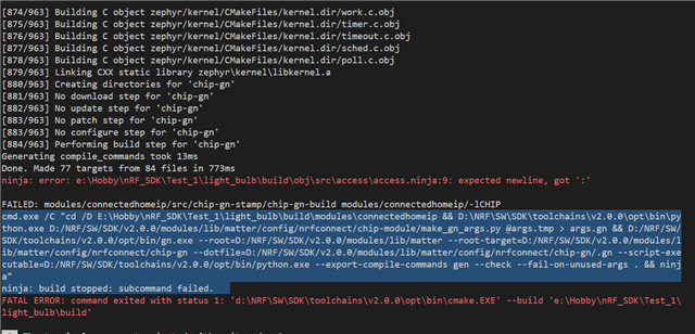

Error by creating Matter build (access.ninja / cmake.EXE)
we tried to create a Matter build with the Nordic SDK.
Following Steps are done by us which are causing the error:
Clicked nrF connect extension in VS --> Create a new application --> Select application template (matter/light bulb) --> Create application --> project created successfully --> under applications tab --> build config for light bulb --> gives error
Hatdware is a Windows System with the Nordic VS Extension.
i already talked to Mr Kurz which told me to open a ticket.
I hope someone can help us.

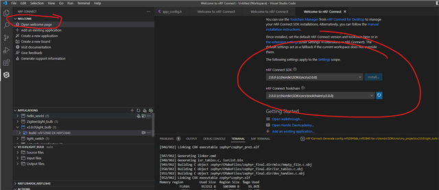

    thanks for the reply.
    1. SDK v2.0.0
    2. nrF 52840
    3. Not performed any changes, followed normal steps: Clicked nrF connect extension in VS --> Create a new application --> Select application template (matter/light bulb) --> Create application --> project created successfully --> under applications tab --> build config for light bulb --> gives error
    4. So far this is the only error
    best regards
    Pascal
    Thank you for supplying the information. The build went fine for me when doing the following:
    Open nRF Connect for Desktop -> Toolchain Manager -> Open VS Code for nRF Connect SDK v2.0.0 -> Select nRF Connect Extension in VS Code -> Create a new application --> Select application template (matter/light bulb) --> Create application --> project created successfully -->under applications tab -->  select build target nrf52840dk_nrf52840 --> build

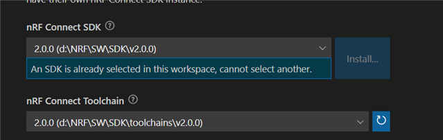

    1) Can you verify under quick setup that the correct toolchain is selected?
    2) If this is correct,  can you try to remove all build configurations in your application folder and redo the build progress and see if you get the same error?
    Andreas

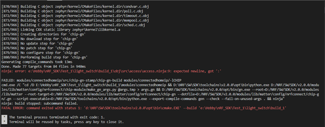

    There are also errors:
    best regards
    Pascal Kaltwasser

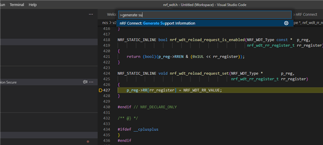

    Since the error was not caused by the initial suggestions I made I am going to need more information. The error could indicate that some changes have been done to the base sample. Has the sample been modified in any way?

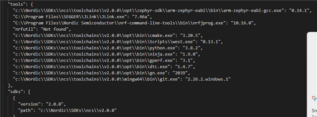

    Could you open vscode, press ctrl+shift+p and search for "Generate support information" and supply the logs for me here?
    What I am interested in is the tools versions:
    Andreas
  • "tools": {
        "d:\\NRF\\SW\\SDK\\toolchains\\v2.0.0\\opt\\zephyr-sdk\\arm-zephyr-eabi\\bin\\arm-zephyr-eabi-gcc.exe": "0.14.1",
        "D:\\NRF\\SW\\JLink.exe": "7.66a",
        "C:\\Program Files (x86)\\Nordic Semiconductor\\nrf-command-line-tools\\bin\\nrfjprog.exe": "10.16.0",
        "nrfutil": "Not found",
        "d:\\NRF\\SW\\SDK\\toolchains\\v2.0.0\\opt\\bin\\cmake.exe": "3.20.5",
        "d:\\NRF\\SW\\SDK\\toolchains\\v2.0.0\\opt\\bin\\Scripts\\west.exe": "0.13.1",
        "d:\\NRF\\SW\\SDK\\toolchains\\v2.0.0\\opt\\bin\\python.exe": "3.8.2",
        "d:\\NRF\\SW\\SDK\\toolchains\\v2.0.0\\opt\\bin\\ninja.exe": "1.9.0",
        "d:\\NRF\\SW\\SDK\\toolchains\\v2.0.0\\opt\\bin\\gperf.exe": "3.1",
        "d:\\NRF\\SW\\SDK\\toolchains\\v2.0.0\\opt\\bin\\dtc.exe": "1.4.7",
        "d:\\NRF\\SW\\SDK\\toolchains\\v2.0.0\\opt\\bin\\gn.exe": "2039",
        "d:\\NRF\\SW\\SDK\\toolchains\\v2.0.0\\mingw64\\bin\\git.exe": "2.26.2.windows.1"
    None of the samples are updated or changed, and above there are the tools log as requested.
  • Seems like everything is fine. Is this issue present when building other samples as well?

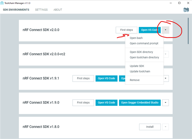

    The next step in ensuring that NCS is installed properly that I would like you to test is:

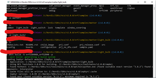

    1) Build with command west:
    Open nRF Connect for Desktop, select Toolchain manager, right click the arrow and open a bash.
    Then navigate to the matter light bulb sample folder and try to build the sample with
    west build -b nrf52840dk_nrf52840 -p
    Andreas
