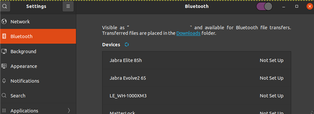

  • Hi
    Do you mean this:
    $ cd zephyr/samples/bluetooth/hci_usb/
    $ west build -b nrf5340dk_nrf5340_cpuapp_ns
    $ west flash --recover

    //My device is not listed here.
    //So I reconnect the nRF5340DK to the nRF USB connector instead.
    $ lsbusb
    Bus 002 Device 003: ID 2109:0813 VIA Labs, Inc.
    Bus 002 Device 002: ID 2109:0813 VIA Labs, Inc. USB3.0 Hub
    Bus 002 Device 001: ID 1d6b:0003 Linux Foundation 3.0 root hub
    Bus 001 Device 005: ID 0b0e:245e GN Netcom Jabra Link 370
    Bus 001 Device 003: ID 413c:2113 Dell Computer Corp. Dell KB216 Wired Keyboard
    Bus 001 Device 015: ID 2fe3:000b  // <---- This one is new since last time. I know the DK has been connected
    Bus 001 Device 004: ID 2109:2813 VIA Labs, Inc.
    Bus 001 Device 002: ID 2109:2813 VIA Labs, Inc. USB2.0 Hub
    Bus 001 Device 008: ID 046d:c077 Logitech, Inc. M105 Optical Mouse
    Bus 001 Device 001: ID 1d6b:0002 Linux Foundation 2.0 root hub

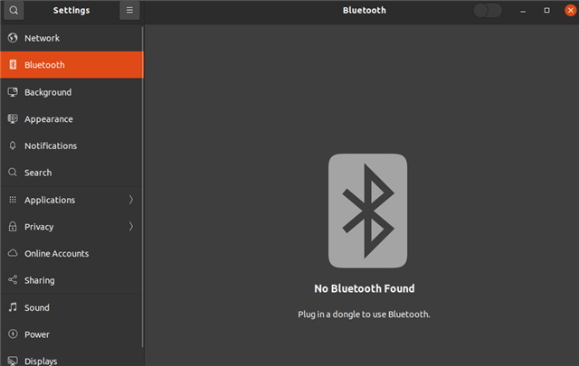

    Then I opened my "Bluetooth Settings" in Ubuntu, it can see Bluetooth devices:
    For reference, this is how my Bluetooth settings look if I have disconnected the Developement Kit:
    Was this what you needed?
