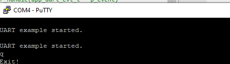

I am trying to run the UART example from the nRF5_SDK_17.1.0 on my nRF52840 board. I can build and run the example, but when I connect through putty, I can only send commands, not receive any. When I debug the program, the text gets printed to the console of the debugger, but when running it, I don't get anything to putty.
I have set up my connection as explained in the example-documentation (Baud rate: 115.200, 8 data bits, 1 stop bit, No parity, HW flow control: None). I'm using Segger-Studio 6.3 (also tried 5.7 and 6.3.2). I also tried the different I/O settings in Options/Library/I/O Settings, but they didn't solve the problem either.

    I have tested by myself. It works ok.
    If you are using a DK , have you selected the right communication port?

  • I'm pritty sure I did. I tried app_uart_put and app_uart_get and they work when I connect. I also tested it on two different computer with two different OS (Fedora and Windows) and they both run into the same problem.
    My current theory is, that it has something to do with printf.
    Thank you a lot for trying out the example again on your machine and verifying that it works. Unfortunately, I was still not able to get the example running on my machine though.

    Try 3: SDK 17.0,2 and SES 6.32b: app_uart_put
    After a lot of testing, I noticed that I can also use the function app_uart_put to "print" a single character to the console - and this works with putty!
    For the moment, I think I can use app_uart_put to data from my nrf52840 to the console.

  • No I never did. I ended up using the app_uart_put function like this:
    #include "stdint.h"
    void my_print(uint8_t* cString){
      int i = 0;
      while(cString[i]!='\0'){
        while(app_uart_put(cString[i])!=NRF_SUCCESS);
        ++i;
    Not the nicest solution, but it was enough for what I needed.
