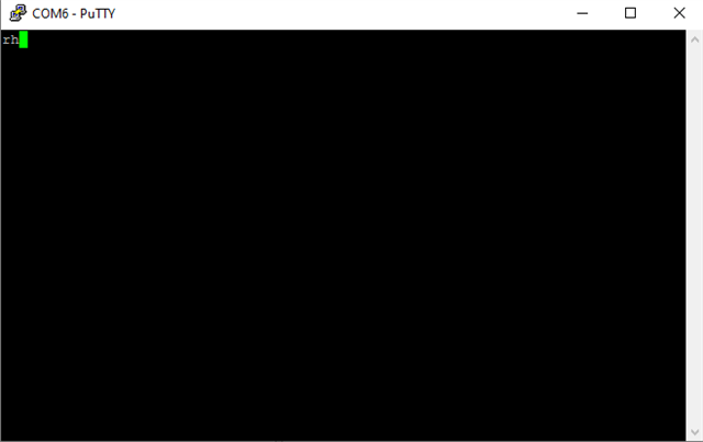

I am trying to run the UART example from the nRF5_SDK_17.1.0 on my nRF52840 board. I can build and run the example, but when I connect through putty, I can only send commands, not receive any. When I debug the program, the text gets printed to the console of the debugger, but when running it, I don't get anything to putty.
I have set up my connection as explained in the example-documentation (Baud rate: 115.200, 8 data bits, 1 stop bit, No parity, HW flow control: None). I'm using Segger-Studio 6.3 (also tried 5.7 and 6.3.2). I also tried the different I/O settings in Options/Library/I/O Settings, but they didn't solve the problem either.

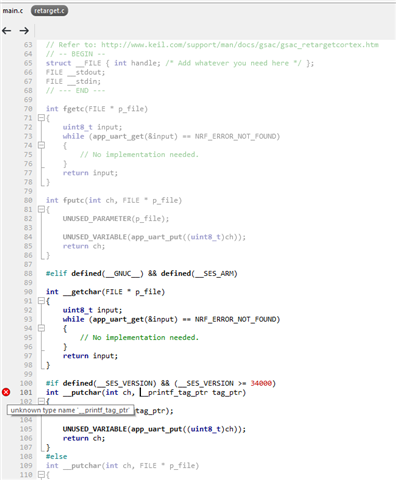

    3. Select "Build">"Build and Run" in SES: Here I get the following error: "unknown type name '__printf_tag_ptr' in retarget.c
    4. Now I changed in options>Library>Library I/O> None to RTT

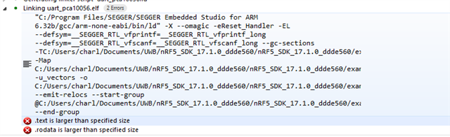

    5. Again, Build > Build and Run
    6. This time I get a new error ".text is larger than specified size" and ".rodata is larger than specified size"
    7. trying fixes that were recommended in other posts such as excluding the retarget file or deleting it did not work.
    8. similar issues with SDK 17.1.0 and SES 6.3 / 5.5 -> not able to build the example

    3. Retarget.c error : "unknown type name '__printf_tag_ptr'
    4. options>Library>Library I/O> None to RTT

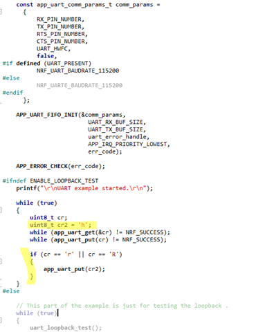

    Try 3: SDK 17.0,2 and SES 6.32b: app_uart_put
    After a lot of testing, I noticed that I can also use the function app_uart_put to "print" a single character to the console - and this works with putty!
    For the moment, I think I can use app_uart_put to data from my nrf52840 to the console.

  • No I never did. I ended up using the app_uart_put function like this:
    #include "stdint.h"
    void my_print(uint8_t* cString){
      int i = 0;
      while(cString[i]!='\0'){
        while(app_uart_put(cString[i])!=NRF_SUCCESS);
        ++i;
    Not the nicest solution, but it was enough for what I needed.
