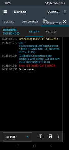

In cases where connection fails to establish, the device firmware does not get any intimation of
connection request or connection related errors, tracked in BLE event handler registered in NRF_SDH_BLE_OBSERVER.

9) When we try to connect the device from nRF connect android app (v4.25.1), app throws GATT ERROR (133) (refer screenshot attached).
