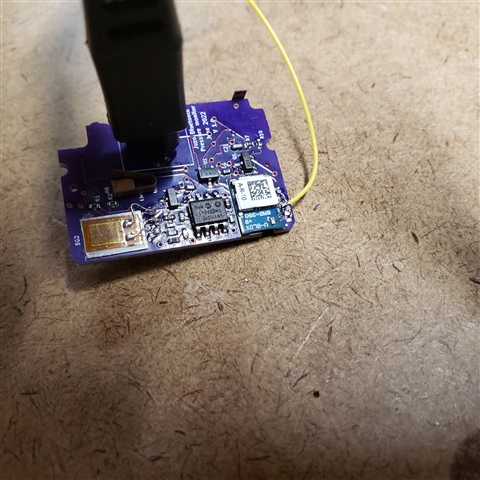

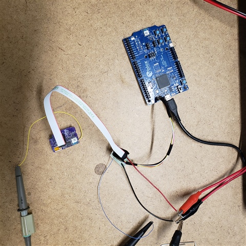

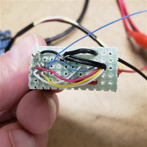

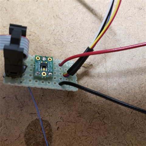

    To describe my setup more fully:  I have a breadboard in between my device and the Development kit.  This board has a header which the TC2030 cable plugs onto, and then wires that go from that header to a 10-pin header connector that plugs into the Development kit. It also has a 3.3V regulator that powers my custom board. The other end of the TC2030 connects to my custom board:
    Dev_Kit (10 pin connector)----------------Breadboard------(TC2030)------------Target Board
                                                                 Power Supply
    I have no connection to the Dev_Kit's SWO pin.
    When I double-checked,  I did notice a short between the TDI pin and the nRESET pin.  Even though that pin does not seem to be implemented, I removed that short - but no joy.

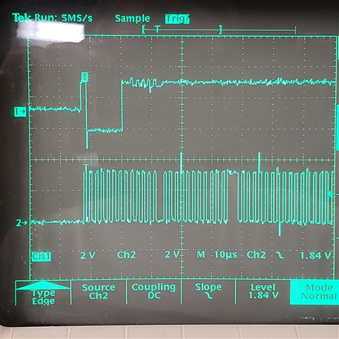

    I put a scope on the SWCLK and SWDIO lines and again verified that I had 0 to ~= 3.3V signals when issuing commands from nrfjprog or JLinkExe.  The fact that I get appropriate level signals would seem to indicate that they are indeed being connected to the BMD-350, since the pull-up resistors are on the chip.
    I also verified that SWO was not connected to GROUND (see my other reply).
    I'm going to build up another board or two and try those.
    Here's a shot of the scope just because it's handy - SWCLK on the bottom, SWDIO on top.   There's a little noise on the DIO line I see at the start of the pulse.  Certainly might be getting a little crosstalk between that and the SWCLK.  I didn't do anything special with the wires between the device and the perfboard.
  • Aye, I have the GND_DETECT and VCC lines connected.  When I just connect to the Dev_Kit, the tools work fine.  In fact, I just erased some test code I had loaded on the Dev_Kit because I didn't have the target board powered up.  When all the connections are there the tools refuse to talk to the target board.
    I've tried a JLink and gotten the same results.
    It's got to be something stupid I'm missing - some pin that I've connected improperly or something.
    The Dev_Kit is the Ublox BMD-350-EVAL - pretty much the same as the Rigol or regular Nordic DK from what I can tell - same 10 pin connector and such.
