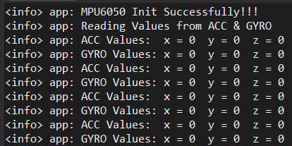

Problem of calculating the value of MPU6050
 MPU6050 cannot calculating the value of 3 axis and the value return is 0. What is problem? How can I fix it ? Thanks for helping me.
AD0 open.Adress is 0x68
Here is my code

  • Hi
    Can you provide the implementation of the MPU6050_ReadAcc(..) and MPU6050_ReadGyro(..) functions as well?
    I don't believe these are a part of the standard library in the SDK.
    In general I would recommend not changing the SDK files directly, but rather make a separate module/file that wraps the SDK files with additional functionality.
    Best regards
    Torbjørn
  • here is mpu6050.c

  • Hi
    Have you tried to check with a scope or logic analyzer what is being sent/received over the I2C bus?
    If yes, would you be able to share the traces?
    Best regards
    Torbjørn
