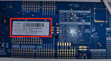

customer get samples with 9160, but find out they are not able get pin code.
i searched the spec, and at command +CPIN, it is not able to read out the pin code, and if i want to set new pin code, i need to know the previous pin code.
if i am correct? so my question is how can we get the pin code?
William.

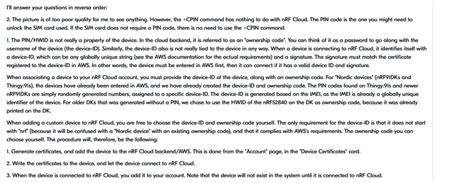

    Not all SIM cards require PIN codes.
    There is no support for reading out the PIN code of a SIM card. What makes you think this should be possible? The PIN code should come with the SIM card when you buy it, if not you should contact the operator.
