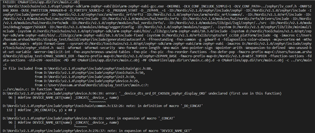

    Thanks for the reply. I have tried with the latest nrfConnect SDK and the following is the error when I open the sample application from the nrfConnect SDK and not a single change. It seems the sample is not compiling fine here.
  • Could you please share the overlay file that was in use when you analyzed SPI?
    Does the overlay look anything like below? I realized &pinctrl might be missing. Please note that I have not tested the below overlay. I will try to do so later, although I do not have the physical display at hand.
