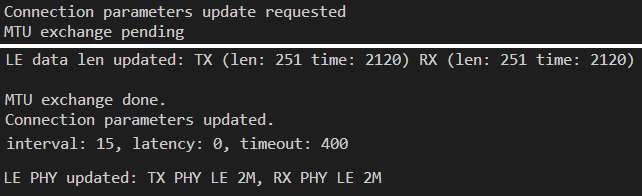

    One more observation I have which is related to the mobile app when update_ble_file_tx_params() function is triggered from nRF5340 the result is different for our mobile app and nrf connect mobile app
    Code for triggering update_ble_file_tx_params():

    When using nRF connect mobile app, below logs appear
    However, when using our mobile app, below logs appear
    Why is it so? As from the nRF5340 side similar functions are triggered.
    And as LE data len is not updating and MTU exchange is failing, the transmission speed is very low.
    -Shubham
  • https://github.com/nrfconnect/sdk-zephyr/blob/ff85910bf8ed1aac0571bca0e7f206782234efbb/include/zephyr/bluetooth/gatt.h#L1340:
     *  @retval -EALREADY The MTU exchange procedure has been already performed.
    Does your application do the MTU exchange procedure more than once?

    However, I need to use below configuration in nRF5340 to be able to communicate with mobile app. If I disable it then communication doesn't happen.
    CONFIG_BT_GATT_AUTO_UPDATE_MTU=y
    Does that mean that MTU exchange is being done even before update_ble_file_tx_params() is triggered from nRF5340?
    Also why the LE data length extension doesn't occur when using our mobile app but it works when using nRF connect mobile application?
    So, does the DLE support depend upon MTU exchange procedure too or there's any other configuration required on mobile app side which is present in nRF connect mobile app but not in ours.

  • Hi Shubham
    Sigurd asked me if I could take a look at this, and what I think might be happening is that your custom mobile app doesn't check or report back when an MTU/connection parameter update is completed, and thus the nRF52 might think the MTU update is already ongoing and makes it fail. I think you need to see how the MTU update request is handled in your mobile app exactly.
    In nRF Connect for Android there is not a specific "mode" to send large amounts of data, but you could try using either the GATT throughput service or the Bluetooth standard object transfer service.
    However, I have a doubt here for our usecase with nRF5340, if you see the below logs appearing while using nRF connect Android app, MTU exchange is happening along with LE data length update.
    So, will only adding MTU update support to our app (if it is not happening) like using the method gatt.requestMtu(498); as mentioned here enough to for MTU and data length extension (DLE) updates?
    Or there's any other added method need to be used on mobile app side which is present in nRF connect mobile app and not in our custom app?
