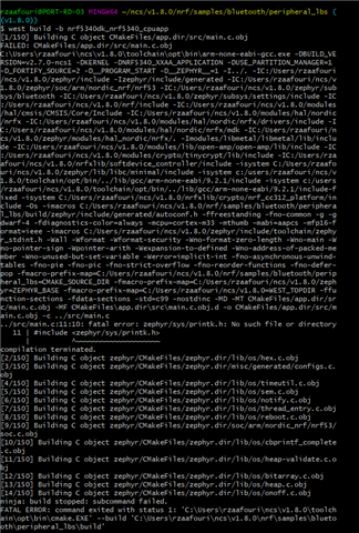

    but the problem here is, i'm always unable to build the application nor to program the merged.hex or the merged_CPUNET.hex. and this is because the app isn't building
    i have several errors that occured when i ran: west build

    [177/201] Building C object zephyr/kernel/CMakeFiles/kernel.dir/queue.c.obj
    [220/251] Building C object CMakeFiles/app.dir/src/main.c.obj
    FAILED: CMakeFiles/app.dir/src/main.c.obj
    C:\Users\rzaafouri\ncs\v1.8.0\toolchain\opt\bin\arm-none-eabi-gcc.exe -DBUILD_VERSION=v2.7.0-ncs1 -DKERNEL -DNRF5340_XXAA_APPLICATION -DUSE_PARTITION_MANAGER=1 -D_FORTIFY_SOURCE=2 -D__PROGRAM_START -D__ZEPHYR__=1 -I../. -IC:/Users/rzaafouri/ncs/v1.8.0/zephyr/include -Izephyr/include/generated -IC:/Users/rzaafouri/ncs/v1.8.0/zephyr/soc/arm/nordic_nrf/nrf53 -IC:/Users/rzaafouri/ncs/v1.8.0/zephyr/subsys/bluetooth -IC:/Users/rzaafouri/ncs/v1.8.0/zephyr/subsys/settings/include -IC:/Users/rzaafouri/ncs/v1.8.0/nrf/include -IC:/Users/rzaafouri/ncs/v1.8.0/modules/hal/cmsis/CMSIS/Core/Include -IC:/Users/rzaafouri/ncs/v1.8.0/modules/hal/nordic/nrfx -IC:/Users/rzaafouri/ncs/v1.8.0/modules/hal/nordic/nrfx/drivers/include -IC:/Users/rzaafouri/ncs/v1.8.0/modules/hal/nordic/nrfx/mdk -IC:/Users/rzaafouri/ncs/v1.8.0/zephyr/modules/hal_nordic/nrfx/. -Imodules/libmetal/libmetal/lib/include -IC:/Users/rzaafouri/ncs/v1.8.0/modules/lib/open-amp/open-amp/lib/include -IC:/Users/rzaafouri/ncs/v1.8.0/modules/crypto/tinycrypt/lib/include -IC:/Users/rzaafouri/ncs/v1.8.0/nrfxlib/softdevice_controller/include -isystem C:/Users/rzaafouri/ncs/v1.8.0/zephyr/lib/libc/minimal/include -isystem c:/users/rzaafouri/ncs/v1.8.0/toolchain/opt/bin/../lib/gcc/arm-none-eabi/9.2.1/include -isystem c:/users/rzaafouri/ncs/v1.8.0/toolchain/opt/bin/../lib/gcc/arm-none-eabi/9.2.1/include-fixed -isystem C:/Users/rzaafouri/ncs/v1.8.0/nrfxlib/crypto/nrf_cc312_platform/include -Os -imacros C:/Users/rzaafouri/ncs/v1.8.0/nrf/samples/bluetooth/peripheral_lbs/build/zephyr/include/generated/autoconf.h -ffreestanding -fno-common -g -gdwarf-4 -fdiagnostics-color=always -mcpu=cortex-m33 -mthumb -mabi=aapcs -mfp16-format=ieee -imacros C:/Users/rzaafouri/ncs/v1.8.0/zephyr/include/toolchain/zephyr_stdint.h -Wall -Wformat -Wformat-security -Wno-format-zero-length -Wno-main -Wno-pointer-sign -Wpointer-arith -Wexpansion-to-defined -Wno-address-of-packed-member -Wno-unused-but-set-variable -Werror=implicit-int -fno-asynchronous-unwind-tables -fno-pie -fno-pic -fno-strict-overflow -fno-reorder-functions -fno-defer-pop -fmacro-prefix-map=C:/Users/rzaafouri/ncs/v1.8.0/nrf/samples/bluetooth/peripheral_lbs=CMAKE_SOURCE_DIR -fmacro-prefix-map=C:/Users/rzaafouri/ncs/v1.8.0/zephyr=ZEPHYR_BASE -fmacro-prefix-map=C:/Users/rzaafouri/ncs/v1.8.0=WEST_TOPDIR -ffunction-sections -fdata-sections -std=c99 -nostdinc -MD -MT CMakeFiles/app.dir/src/main.c.obj -MF CMakeFiles\app.dir\src\main.c.obj.d -o CMakeFiles/app.dir/src/main.c.obj -c ../src/main.c
    ../src/main.c:11:10: fatal error: zephyr/sys/printk.h: No such file or directory
       11 | #include <zephyr/sys/printk.h>
    compilation terminated.
    [231/251] Building C object zephyr/kernel/CMakeFiles/kernel.dir/work.c.obj
    FAILED: modules/nrf/samples/hci_rpmsg_subimage-prefix/src/hci_rpmsg_subimage-stamp/hci_rpmsg_subimage-build hci_rpmsg/zephyr/zephyr.hex hci_rpmsg/zephyr/zephyr.elf hci_rpmsg/zephyr/merged_CPUNET.hex
    cmd.exe /C "cd /D C:\Users\rzaafouri\ncs\v1.8.0\nrf\samples\bluetooth\peripheral_lbs\build\hci_rpmsg && C:\Users\rzaafouri\ncs\v1.8.0\toolchain\opt\bin\cmake.exe --build . --"
    [233/251] Building C object zephyr/kernel/CMakeFiles/kernel.dir/sched.c.obj
    FATAL ERROR: command exited with status 1: 'C:\Users\rzaafouri\ncs\v1.8.0\toolchain\opt\bin\cmake.EXE' --build 'C:\Users\rzaafouri\ncs\v1.8.0\nrf\samples\bluetooth\peripheral_lbs\build'
    can you help solve them please
    Note that i didn't change nothing from the sample of Peripheral_lbs that's whyi don't understand whyit doesn't build
    is there something wrong with my config files ? or should i try to run it on the nrf5340dk_nrf5340_cpunet ?
    can you help me find out what's causing the build fail please
    Kindly thankful,
    To test, can you try to build the zephyr hello world sample?
    (v1.8.0/zephyr/samples/hello_world)
    Sigurd Hellesvik
    My Hello_world sample works very well
    but i'm still getting the same error on the peripheral_lbs project
    infact i'm trying to work according to this link
    but the thing is, in the nrfjrog commands . they are recommanding to run a command to program the merged_CPUNET.hex. what i don't understand is : howcan we program the merged file when it is not created yet. normally this file is created when the build is executed but in the tutorial the build command come in the section after.
    can you relate ?
