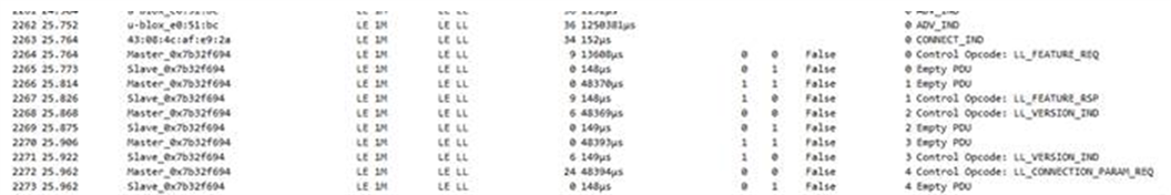

  • Hello Karl.
    This is what I see after selecting my snort device (Etaline Pro).
    As you can see below, all devices are displayed (nothing changes from the "All advertising devices" selection).
    If I then connect with a remote BLE central device and initiate a data exchange, nothing changes yet. It seems that selecting the "Device" pull-down menu has no effect.
    I thank you for your support.
    BR
    Demetrio
