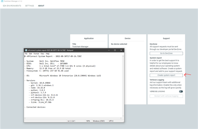

    can you open the nRF connect Desktop app and click the create system report
    Like this
    And share the file with me.
    Jonathan
  • # nRFConnect System Report - 2022-09-01T05-00-21.626Z
    - System:     FUJITSU ESPRIMO P758
    - BIOS:       FUJITSU // American Megatrends Inc. FUJ    - 12500000
    - CPU:        1 x Intel Core™ i5-9400 2.9 GHz 6 cores (6 physical)
    - Memory:     5.6 GB free of 15.7 GB total
    - Filesystem: C: (NTFS) 236.3 GB 60.5% used
    - OS:         Microsoft Windows 10 Pro (10.0.19042) Windows ia32
    - Versions
        - kernel: 10.0.19042
        - git: 2.36.1.windows.1
        - node: 14.16.0
        - python: 3.9.0
        - python3:
        - nrf-device-lib-js: 0.4.11
        - nrf-device-lib: 0.11.8
        - nrfjprog DLL: 10.15.4
        - JLink: JLink_V7.58b
    - Connected devices:
