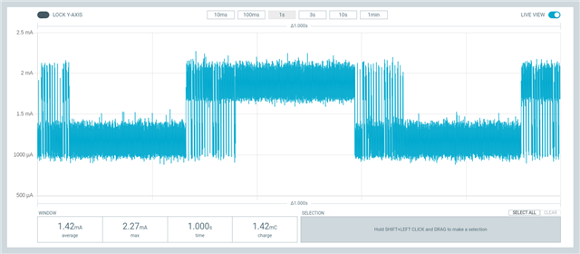

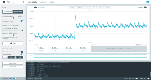

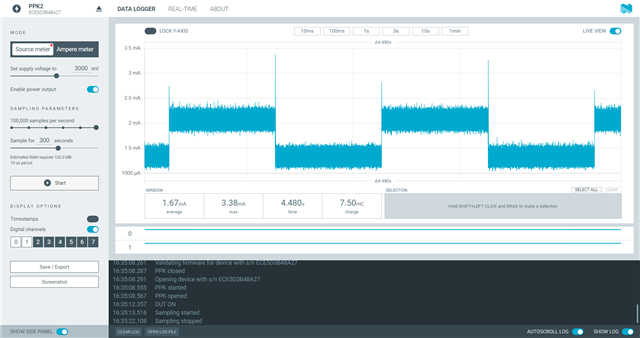

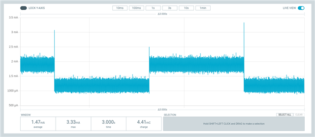

    Can you upload a screenshot of the noisy test samples, as I tried again on another DK and PPK combo and I still see the same "tall and clean" toggling on my end. If you'd like I can set up a lower power sample as well that puts the device to a proper low power mode when the LED is off for example.
    Simon

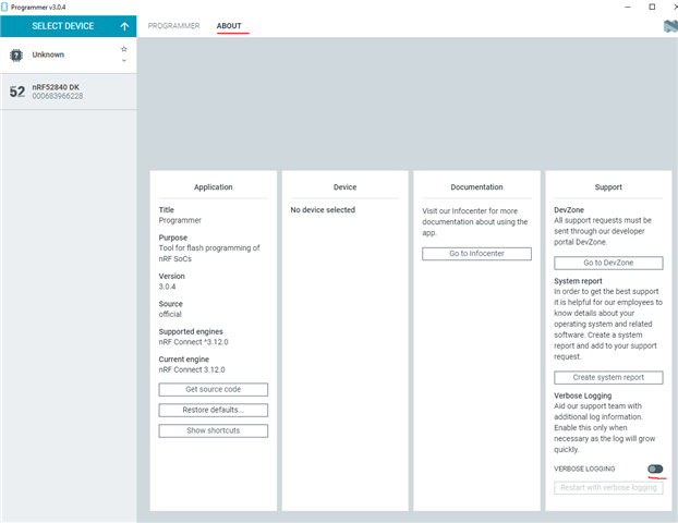

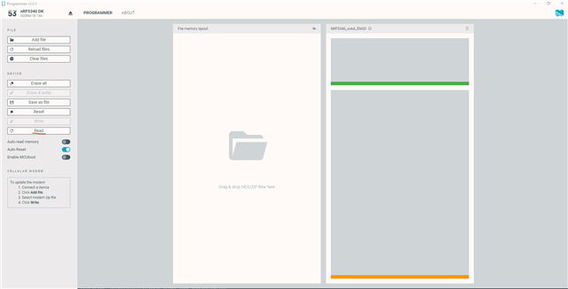

    2022-09-12T15:41:10.566Z ERROR Unsupported device.
                The detected device could not be recognized as
                neither JLink device nor Nordic USB device.
    0000 is replacement of real user/company name.
    Any ideas ?
  • Thanks!
    My initial guess is that the solder bridge(s) (SB40 and SB41) are cut, and not shorted to resume normal DK operation. If that's not it, and all the switches are in default mode, please try enabling Verbose logging and upload that log.
