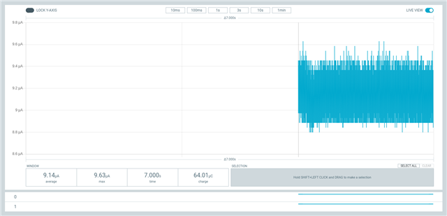

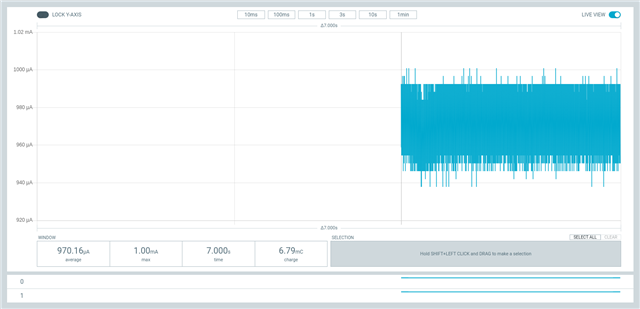

I aw various other posts ( nRF5340-DK Low Power Configuration Issues)
and the post on Optimizing power on nRF53 designs  but I never get results that low.
The Blog post doesn't really help, since it only states the Zephyr settings and not the
real software settings. Using the example from the post mentioned above gets the same
results (650 uA on 1800 mV)
Our setup:
PPK as power supply for NRF5430-DK (version 0.11.0)
SB40 is bridged
SW6 to DEFAULT (if no nRFOnly, more current seems to run)
SW9 to VDD
SW10 to ON
For software:
basic loop, while(1) { WFI(); }
and 100 Hz RTC1 based TICK.
HFCLKSRC = HFINT
Other peripherals idle.
When I measure is still get around 650 uA when setting PPK supply to 1800 mV. (around 1000 uA when 3000 mV).
So 2 questions:
- is the hardware setup ok?
- what can we do in the software?
