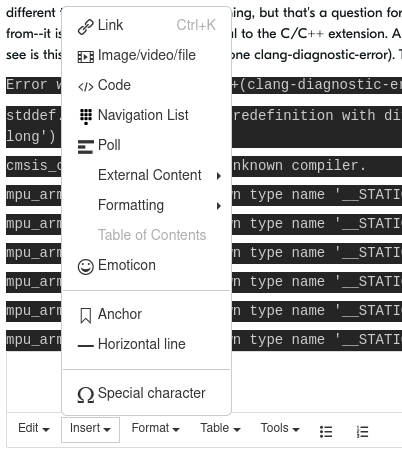

  • Hello Burt,
    Sorry for the late answer, I am going to check it on Windows tomorrow. Thank you for all the feedback.
    By the way, a small tip for the future: for inserting code/log snippets I would recommend clicking insert->Code in the text editor. Makes things easier to read and follow.
    Like in this screenshot:
    Michal
