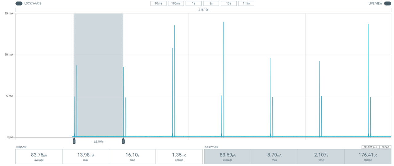

  • GiulianoFranchetto said:
    Are you sure you are indeed using INT mode and not ASYNC mode here ?
    Yes, I'm pretty sure. I also modified main.c to look like this:
    void main(void)
    	const struct device *lpuart = DEVICE_DT_GET(DT_NODELABEL(lpuart));
    	printk("LPUART sample started\n");
    	__ASSERT(device_is_ready(lpuart), "LPUART device not ready");
    	//if (IS_ENABLED(CONFIG_NRF_SW_LPUART_INT_DRIVEN)) {
    		interrupt_driven(lpuart);
    	//} else {
    	//	async(lpuart);
    Then I modified the delay between each transfer to 2.1 seconds
    static void interrupt_driven(const struct device *dev)
    	uint8_t c = 0xff;
    	uart_irq_callback_set(dev, uart_irq_handler);
    	uart_irq_rx_enable(dev);
    	while (1) {
    		uart_irq_tx_enable(dev);
    		k_sleep(K_MSEC(2000));
    		uart_poll_out(dev, c);
    		k_sleep(K_MSEC(100));
    When looking at the result in the Power Profiler, I saw a delay of 2.1 second between each transfer and a current of 83uA.
    I used the nRF5340 DK v0.11, the board nrf5340dk_nrf5340_cpuapp and NCS v2.0.0. I also connected together req (P1.14) to rdy (P1.15) and RX (P1.12) to TX (P1.13).
    I did not get any warnings when building the project with NCS v2.0.0. Here is the build output:

    I didn't get any compile errors like you:
    If I try the same config with nRF9160, it does not compile:
    I'm uploading it again, since I can see that it got corrupted in the last reply:
    8267.lpuart_test_v2.zip
    Simon
