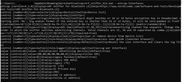

The cli tests runs fine.

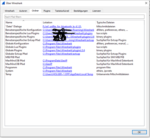

wireshark uses the folder:

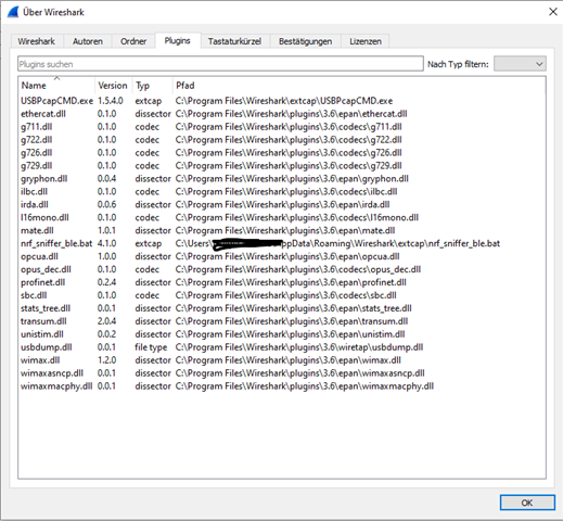

also the plugin is listed in wireshark

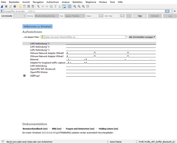

the toolbar is also there

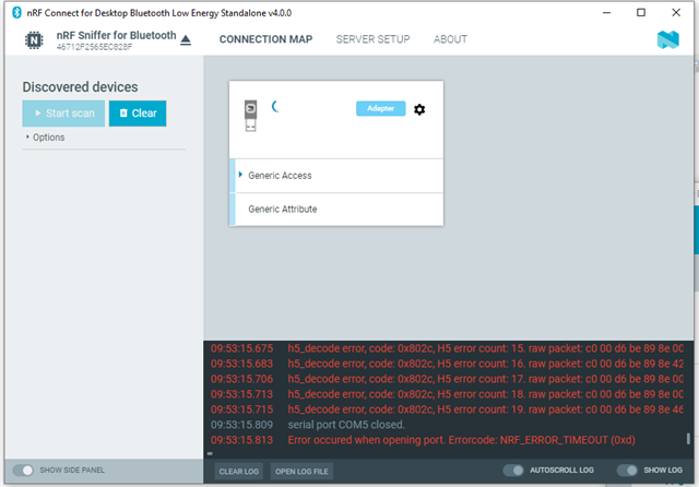

The Device is also listed in windows.
The final question, why is my dongle not listed under the capture devices? What has changed?!
