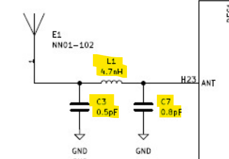

Schematic:
    There is no antenna matching circuit in your schematic. Ignion recommends using a pi matching network for this antenna, as the antenna performance is dependent on the board size/shape and nearby components. Without this matching network the antenna may not be tuned correctly for the 2.4GHz frequency band, and the radiated power can be very low. Ignion can help you with selecting the correct components/values for the matching network.
    The 32MHz crystal frequency accuracy must also be within 40ppm for the radio to be compatible with BLE. If the crystal is loaded incorrectly the frequency offset of the carrier may be outside this 40 ppm limit. What is the part number for the 32MHz crystal you are using?

    1. The pi network is in the updated wiring diagram and I don't think that is the problem.
    Are you referring to C3, L1 and C7?
    These are the radio matching/filtering circuit, they can't be used to match the antenna impedance as well.

  • Since the firmware works correctly on the nRF52840 DK the problem would be with the custom hardware. As I mentioned, if the antenna is not tuned correctly the very little power will be transmitted. If C3, L1 and C7 are the only components between the ANT pin and the antenna, I expect the antenna impedance will not be tune to 50 ohm as is required for good antenna performance.

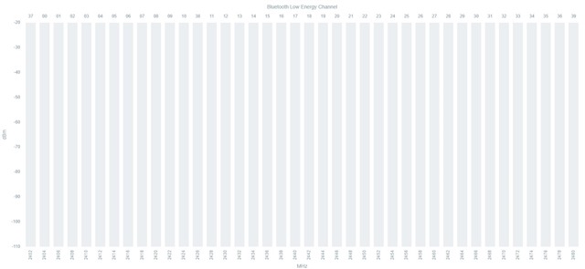

  • I am not very convinced that the problem is the antenna, okay the signal might be very weak but not nonexistent. I also tried to run a test via RSSI Viewer but nothing, it is as if the antenna is not totally connected.
    Could there be some error in the circuit? I followed configuration no. 6.
    https://infocenter.nordicsemi.com/index.jsp?topic=%2Fps_nrf52840%2Fref_circuitry.html
    I cannot find the problem, perhaps I should redesign the board using an antenna PCB as in the dk. However, before redesigning the board I would like to be sure that the problem is that.
