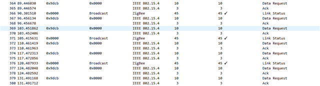

Wireshark_poll_interval_ok.pcapng     Wireshark_poll_interval_error.pcapng

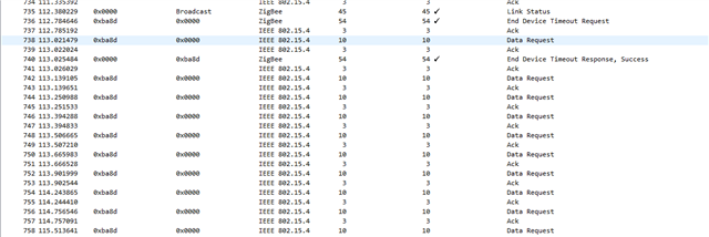

It works perfectly when connected to a particular gateway, but not when connected to another gateway. The polling interval is too fast (approx 200ms) in the non-working gateway, be whatever the value set using zb_zdo_pim_set_long_poll_interval..

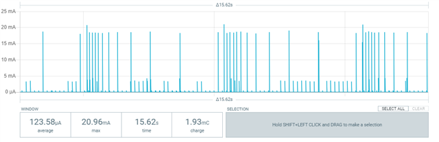

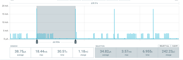

Attached are the Wireshark and PPK logs for both working and non working gateway.

    I think I'll need some more details on these gateways you're using. What is the difference between the "particular" working gateway compared to the other one that isn't working? Is this two nRF devices or phones/tablets or some other product? I think gateways can request preferred polling intervals as well, so my guess is that that is what's happening. What are the PPK logs supposed to show here? In what I assume is the non-working one, the poll intervals seemt o be very sporadic, or is the device doing something else than just polling here?

    Please ignore the power part of ppk screenshot. The intention of ppk is to show the difference in frequency of polling peaks between the two coordinators. This can be validated with the attached wireshark sniffer logs.

    The attached screenshots of the sniffer can give an idea about the difference between the two coordinators.
    From looking at the sniffer traces, they both seem similar, except in the request for setting the poll interval. Where the connection to Conbee II seems to set the keep alive timeout to false, while it is set to true in the other poll interval request.
    I think that a gateway will always have the last say when it comes to most parameter negotiations, poll intervals included, so it might be that the Alexa doesn't allow/support the poll interval you're suggesting.

        We found the problem to be in setting the value of long poll interval and keep alive timeout. As keep alive timeout is less and it is more or less equal to long poll interval, it created the problem. We are able to achieve the required polling interval by increasing the keep alive timeout to a large value.
