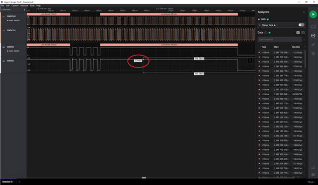

I'm trying to do my first "hello world" communication to the chip on the SWD bus through a:
pyocd client -> CMSIS-DAP firmware -> MAX32625PICO -> nRF52840.
I get this error:
Exception while initing board: No ACK received

0000735 D Default wire protocol selected; using SWD [dap]
What I did so far:
- I'm applying 5v to the VDDH, I get 1.8v out at the VDD.
- The P0.18 pin is pulled high but I don't think it matters on a blank chip.
- I see SWDIO pulled high and SWDCLK pulled low when idle.
- When communicating, the SWD signals look good but I also try lowering the clock speed from 1MHz to 100KHz to see if that would help. It doesn't.
My question:
- Any idea what I could try next?
