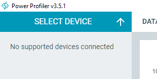

The 'Select Device' column says "Connect a Nordic development kit to your computer" when the Power Profiler is NOT plugged in. This imediately changes to "No supported devices connected" once the Power Profiller kit is plugged in.
I followed the instructions here to put the Power Profiler kit into bootloader mode but the Power Profiler software still said "No supported devices connected". - devzone.nordicsemi.com/.../366832

    I'm getting the same "Connect a Nordic development kit to your computer" message, and the PPK2 does not show up in the list.

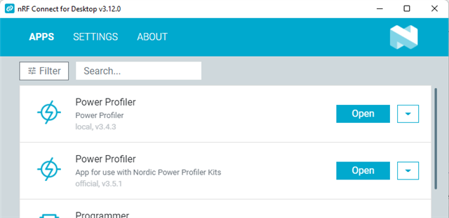

    The reported workaround in these cases was downgrading the Power Profiler version. Could you try downgrading to version 3.4.3? It can be done as follows:
    1. Download the v3.4.3 archive directly from this URL: https://developer.nordicsemi.com/.pc-tools/nrfconnect-apps/pc-nrfconnect-ppk-3.4.3.tgz
    2. Place it in C:\Users\%USERPROFILE%\.nrfconnect-apps\local on Windows, or ~/.nrfconnect-apps/local on Linux
    3. Open nRF Connect for Desktop. The app should be visible:
    On my system I can have the old and new version installed side by side. However we used to recommend people to uninstall the newer version first, so please try that if you meet issues.

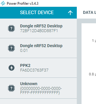

    Hopefully v3.4.3 now lists your PPK2:
    If the above doesn't work, please try unplugging other connected JLink devices (if any). If that doesn't work, we might have to consider changing the PPK firmware.
    When running v3.4.3 I notice that "Select Device" lists all of my connected nRF devices, while in v3.5.1, only the PPK2 is listed. So my current suspicion is that there is some device filtering going on in the newer versions, and it might be so strict that your PPKs are unintentionally filtered out.

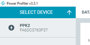

    On our setups the Power Profiler recognises the PPK and shows the following:
    ^ PPK disconnected
    ^ PPK connected
    I hope the workaround fixes your issue for now. As for an actual solution, I'll see if the PPK team can pinpoint the exact cause, and issue a fix.

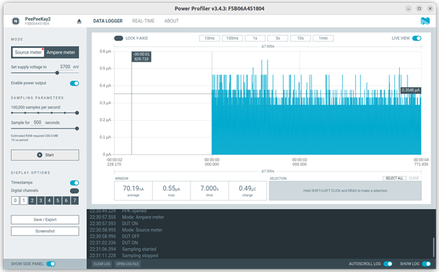

  • The fix   described worked for us!
    It's working now on the v3.4.3 Power Profiler.
  • Hello Raoul, thank you for the detailed instructions!
    It works fine, the PPK2 shows up in the list instantly with v3.4.3...
