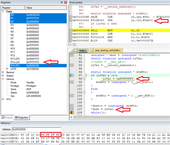

However, the link register value returned does not match what is shown in the Keil uVision registers window as seen below.
Note that I have no trouble reading the PSP or MSP. But for some reason I cannot read the link register,. Replacing __ASM("lr") with __ASM("r14") resulted in the same behavior. Oddly enough, when I hover my mouse over __ASM("lr"), it shows the correct value as seen in the register window. Lastly, looking at the HardFault_Handler() implementation in the Nordic examples as found in hardfault_handler_keil.c, it looks like the link register LR is checked using "tst lr, #4".
Any idea as to why I cannot read the link register using ASM("lr")? The same code works on a STM MCU in Keil uVision, but Nordic does not work.

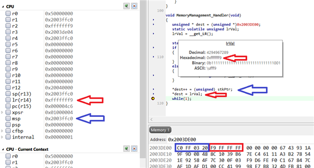

  • I ran a test with the following parameters on a nRF52840 devkit (PCA10056) rev 2.0.2:
    • Project: C:\Nordic\nRF5_SDK_15.2.0_9412b96\examples\peripheral\blinky\pca10056\blank
    • Keil uVision 5.17.0
      • Optimization Level: 0
    • SES (Segger Embedded Studio) 5.10a
      • Optimization Level: None
    • main.c (Same exact code running in both IDE's)
    Here is the code for main.c (I can send you the project if need be):

    Result:
    • Segger Embedded Studio works (The correct LR value is written to RAM)
    • Keul uVision does not work (Some garbage data is written to RAM for LR)
    Segger Embedded Studio (Works):

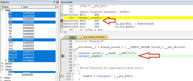

    Keil uVision (Does not work):
    I am not an assembly expert, but further investigation shows that for Keil, the __get_LR() function is being turned/optimized into a NOP:

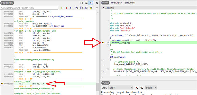

    Segger Embedded Studio (Correct assembly):
    Keil uVision (Incorrect assembly):

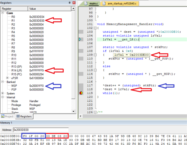

    So it seems to me that maybe the Keil compiler for Nordic doesn't recognize __ASM("lr") and it is being optimized out? Hopefully you can explain why this may be happening?
    Derek
  • Nordic has done nothing special to this compiler, it is the generic ARM compiler that is being used and seems like that instruction is being optimized out in Keil. You can probably try to use __return_address() instead of __get_LR() to see if that works.
    Normally with ASM code and volatile being used in __get_LR() I would assume that nothing should have been optimized away here but seems like there is buggy behavior here on the ARm Keil compiler end.
