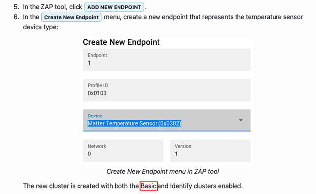

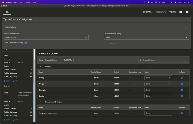

Hi Nordic Guys,
hope you can help following issue (I think the issue is still mentioned in Ticket https://devzone.nordicsemi.com/f/nordic-q-a/87410/corrupt-matter-zcl-file-generation-matter-template-project, Case ID: 288305).
I try to extend the matter-template example from the nRF SDK. Out off the box the example compiles, build and links The application can be copied to the nRF5340DK board and works.
If I add a new endpoint, like it is described in https://developer.nordicsemi.com/nRF_Connect_SDK/doc/latest/nrf/ug_matter_gs_adding_clusters.html#ug-matter-creating-accessory and let the generator.py script do its work, the result is an unbuild-able application.
See the following build-output:
/Users/bennynestler/workspaces/matter/nRFConnect/matter-template/src/zap-generated/endpoint_config.h:570:3: error: conversion from '<brace-enclosed initializer list>' to 'EmberAfDefaultOrMinMaxAttributeValue' is ambiguous

    Seems to be that the zap - Tool enables more than the described clusters (of your guide). Should I try to deactivate some of the clusters?
    What does "basic" - Cluster means in your description?
    Where are more Cluster which are enabled by default!
