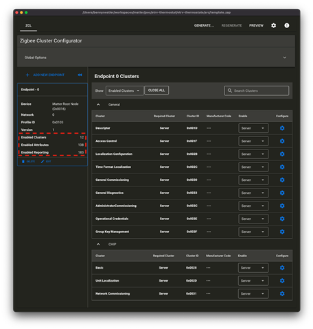

  • Hi Benny,

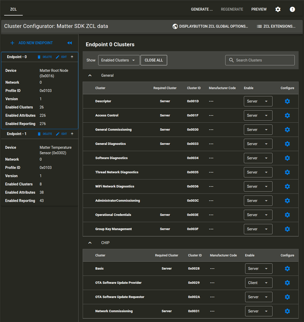

    Can you check which clusters are enabled on endpoint 0 and whether any of them are OTA? From the left side of your picture I see that endpoint 0 only has 5 clusters enabled, while when I go through the guide on my side I have 26 enabled clusters. The issue might be that you are missing some mandatory clusters for the Matter Root Node, such as OTA. This is what endpoint 0 looks like on my side:
    Marte
  • Hi
    thanks for your hint. But that's only a fault/issue of the zap tool.
    If you click on Endpoint 1, the left overview frame of Endpoint 0 changes as well and vice versa. But I thinks that's only a view issue.
    But there was a valuable aspect in your picture, that's not described in the SDK documentation. The Endpoint 0 is not configured as "Matter root node" if I load the template.zap file from the template example.
    I try to change the Endpoint 0 to the "Matter Root Node" and see what is the result.

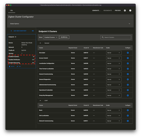

    3.) Edit Endpoint 0 and choose "Matter Root Node" from device list. Looks like this
    --> Looks similar but not equal to yours  ; but the right panel doesn't show 26 enabled Clusters. There are only  12! (And yes, I tried to scroll down, to the supposedly rest of 14 enabled Clusters)
    4.) Save the file and quit the zap-tool.

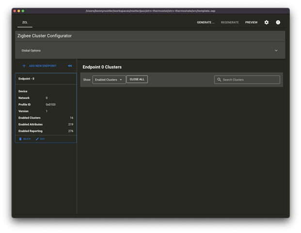

    5.) Reopen the src/template.zap file with zap-Tool. Looks like this
    The numbers are changed ... !? I think that is the correct view!

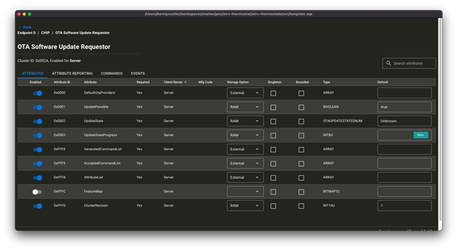

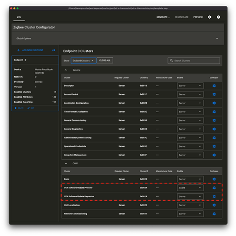

    6.) Add the missing Cluster in the CHIP category
    - OTA Software Update Provider (0x0029) --> Choose Client
    - OTA Software Update Requestor (0x002A) --> Choose Server

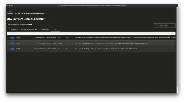

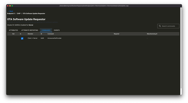

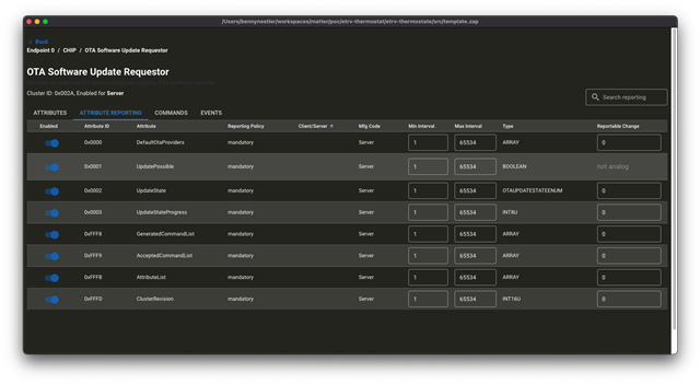

    7.) Configure Cluster OTA Software Update Requestor
    - enable all required Attributes, Attributes Reporting, Commands and Events
    8.) Save the file (if possible --> I've issues with saving of files; very often my changes couldn't be saved and the zap tool don't offers the save menu entry; the only thing which helps is to restart the tool and retry in a slitly different change order )

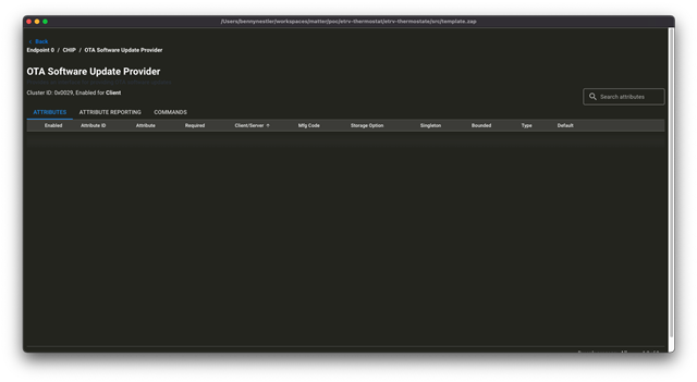

    9.) Try to configure the OTA Software Update Provider
    --> This action always leads to freeze the zap -Tool
    The only exit from this state, is to exit the zap tool (Menu --> Electron --> Quit Electron or Control + C in Terminal)

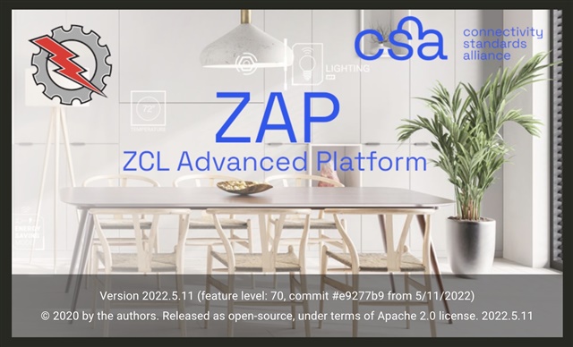

     can you verify my steps/issues with the zap tool?
    My zap-tool About window looks like following
