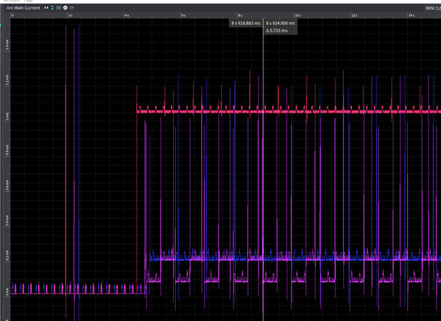

    I've now copied over our interrupt code, so I can test it in isolation from the rest of our code. If I initialise the interrupt using a spare unconnected pin, I get current consumption of ~90 uA, and this is with the sense set to NRF_GPIOTE_POLARITY_HITOLO, which I suspect means we're doing edge detection, which adds some extra current. So that's encouraging.
    If I go back to using our external 1000 Hz RTC signal, I get just over 1 mA consumption. But I can set the prescaler on our external RTC to give different interrupt frequencies, and this is where things get weird...
    The pink line is 1000 Hz interrupts, and just over 1 mA current. The blue line is 250 Hz interrupts, and about 220 uA. The purple line is 500 Hz and oscillates between ~90 uA and ~220 uA.
    (The low power at the beginning is 2.5 seconds of sleep, the code to set up our external RTC over spi, and then 2.5 seconds of sleep again)
    All I can think is that the timing of the MCU going to sleep somehow requires > 1 ms for it to kick in, and so at 1000 Hz interrupts, we never get there. Or rather, I guess the idle current still has the HF oscillator on for ~1 ms?

    Have you checked how long the execution time of the interrupt is? You can use GPIO toggling in the interrupt handler to check that, or toggle a GPIO at the end of the handler and compare this to the GPIO input. It is also possible to use DPPI and GPIOTE to toggle a GPIO from the POWER->EVENTS_SLEEPENTER and EVENTS_SLEEPEXIT to see when the CPU is actually in sleep.
    If for instance the interrupt takes 250us to complete, the ~1mA avereage current makes sense as it will make the Application CPU running about 25% of the time. This also makes sense for the 250Hz current. The 500Hz current does not make sense, but there could be some other error with this. Have you checked that the interrupt actually happens at 500Hz with this configuration? Is there anything in your application that corresponds with the rate that it toggles between high and low current consumption?
