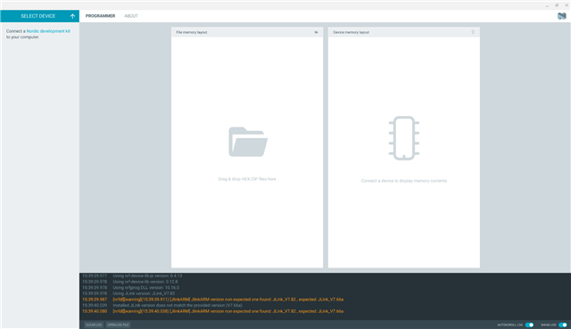

    I have installed the latest one (7.82) and now have those with "verbose logging" enabled :
    15:36:45.868
    Using nrf-device-lib-js version: 0.4.13
    15:36:45.868
    Using nrf-device-lib version: 0.12.8
    15:36:45.869
    Using nrfjprog DLL version: 10.16.0
    15:36:45.869
    Using JLink version: JLink_V7.82
    15:36:45.884
    [nrfdl][warning](15:36:45.789) [JlinkARM] JlinkARM version non expected one found: JLink_V7.82 , expected: JLink_V7.66a
    15:36:46.009
    Installed JLink version does not match the provided version (V7.66a)
    15:36:46.009
    [nrfdl][warning](15:36:46.008) [JlinkARM] JlinkARM version non expected one found: JLink_V7.82 , expected: JLink_V7.66a

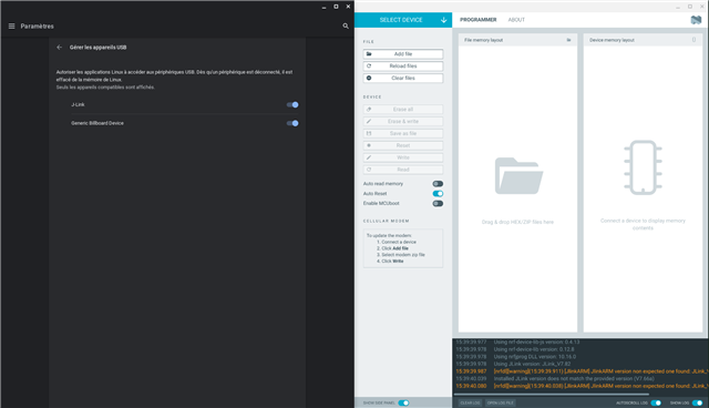

    You could check if the board appears as connected to the COM port using something like Device Manager in Windows 10
    The card is working correctly on a Windows 10 computer, it's on my Chrome OS with Linux developper mode that it is not shown. It appears in device management though.
    Traduction of the french window on the left:
    "Manage USB devices
    Authorize Linux applications to access to USB deveices. Once a device is disconnected, it is removed from Linux's memory. Only compatible devices are shown."
    The device is not showing on "Select device" menu :
    Thanks !
    Gillen
