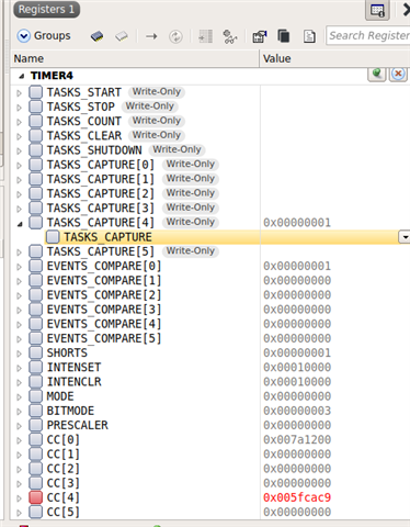

NRF_TIMER_TASK_CAPTURE4 of timer4 is permanent at the same value
I am facing a problem. Two sensors are triggering with data_ready pins and a timer value is captured upon the event. But the value can be stored only in RAM if a context switch happens. But this depends on the processor usage. Therefore, it can happen that one sensor triggers a capture event, but the interrupt routine is delayed due to softdevice processing etc. and in the meantime the other sensor triggers a more recent capture. In this case the timing is screwed.
I've tried to use another capture channel of the same timer but somehow the NRF_TIMER_TASK_CAPTURE4 of timer4 is permanent at the same value. But I have to admit that I am not sure if the event is correctly configured since the code in the header is always greyed out . And I do not know where TIMER_INTENSET_COMPARE4_Msk is defined.
