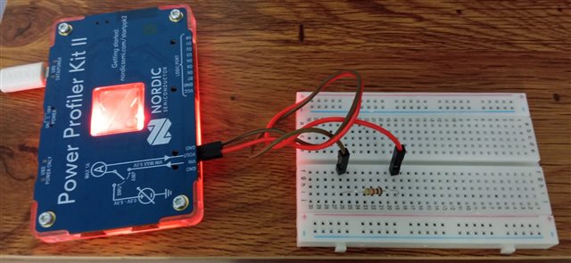

  • How are you measuring this? I ask because he peak currents you describe seem too low, and also a idle consumption of 1.6uA is a bit too low.
    I am using a simple voltimeter, I don't have oscilloscope or the PPK :( . I made the test in two different multimeters, in the one of them the lowest medition is 1.6 uA, in the other the lowest medition is 2.6 uA. I dont have an accurate graph of the current consumtion.

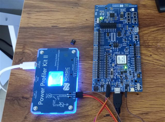

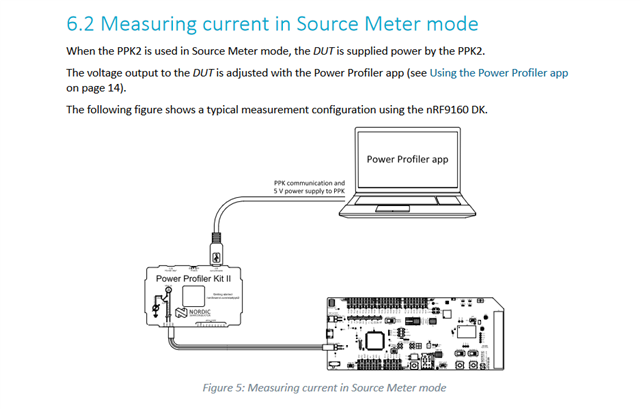

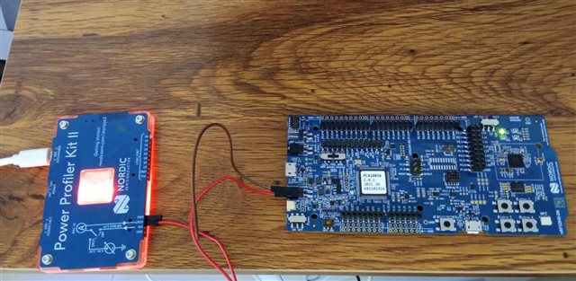

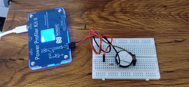

  • sorry for the delat answer , but I able to get a PPK2!!!
    I see. You will not be able to see the peak currents with a multi meter, as they are way to short. An idle current consumption of about 2.6 uA (in system on with the LFCLK and RTC0 running) is a sensible value, though.

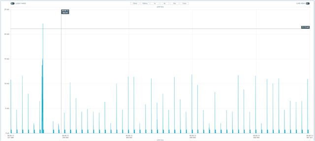

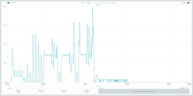

    I got the below information from the PPK2:
    the above, is a normal performant?

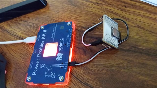

    I do not know what the device is doing, but if it is only Bluetooth, then the peaks are too high. Other than that, the time axis is so cramped that it is not possible to see any recognizable waveform so even if I knew what the device was doing it would not be possible to say much about it from this plot.
    If you only use Bluetooth, then the average current consumption here is too high (you can compare with the online power profiler to get ballpark numbers). That could be related to a measurement issue, as as mentioned the peaks in your plot are suspiciously high. So I would be interested in details about your HW, how you have connected it to the PPK2, and how you have configured it / how you are measuring.
