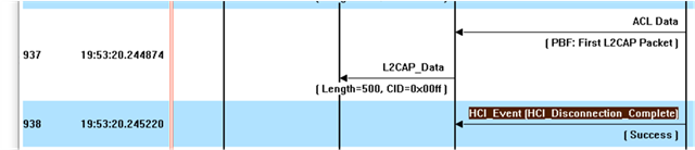

  • hci_snoop20221025194512.cfa
    Hello.
    Now I just have heard how this issue made.
    Android: Nokia 5.3 (Android 11), Galaxy was fine.
    Steps:
    1) Connect Nokia5.3 to wifi. Nokia5.3 connect to Nordic too.
    2) Nokia5.3 move to weak signal area so that wifi disconnected.
    3) BLE disconnected (code 0x3d) this time 0x8(timeout)
    4) We always made this issue.
    BTW SPP device but not Nordic BLE was fine with this test.
    Here is snoop log regarding this issue.
    Can you please let us know any special thing in this log?
    #938 Disconnection message
  • Hi Tim,
    Please double check and confirm if the disconnection reason was 0x3d (MIC error) or 0x08 (connection timeout).
    If it's a connection timeout it's normal to explain it. It's just that the Nokia phone was out of range.
    I assume the SPP device was a Bluetooth Classic device ?
